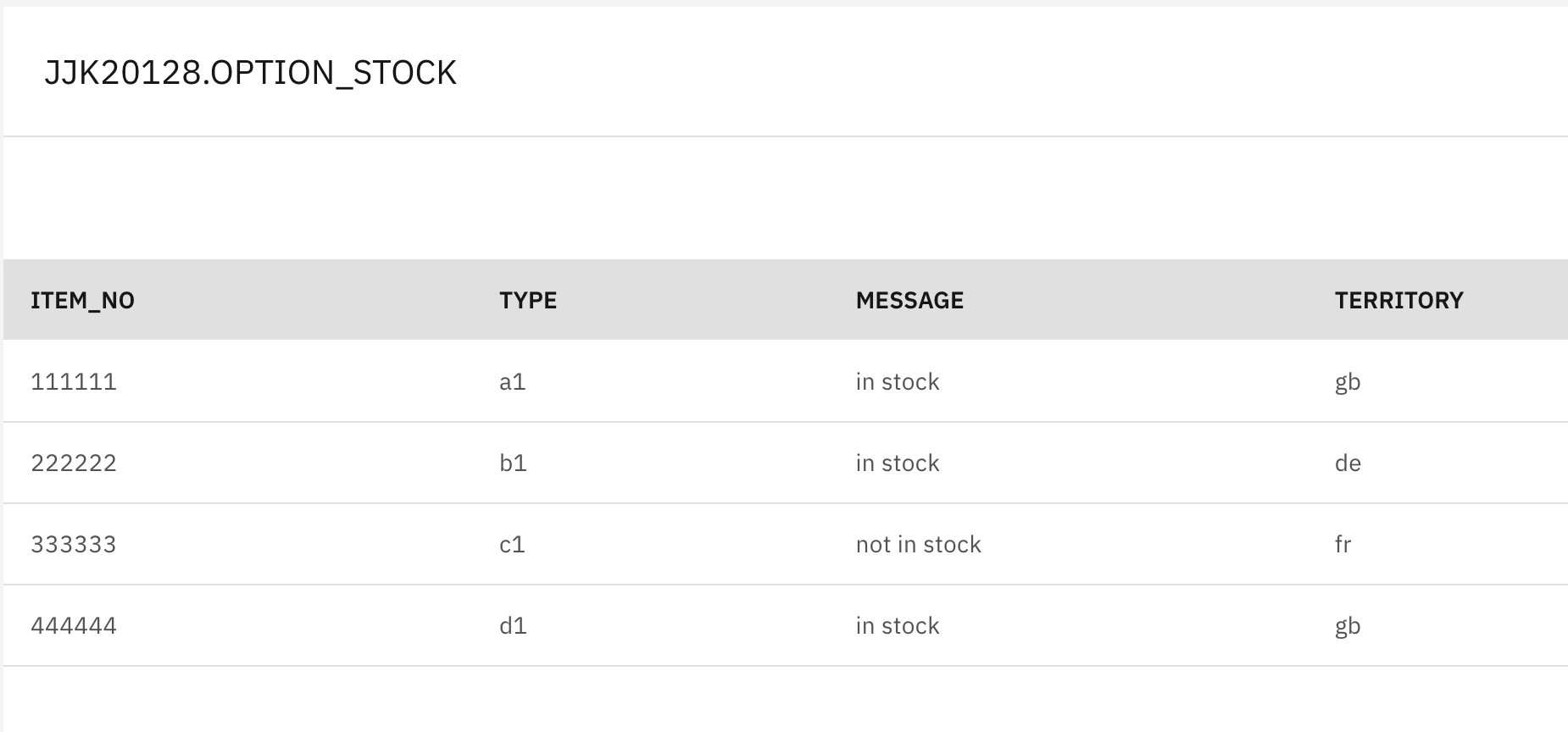

  • Setup some data
enter image description here

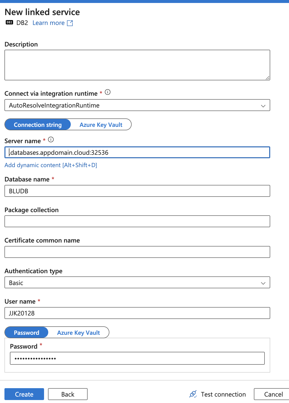

Trying to connect to this via ADF using a new linked service (DB2). I have removed the server name intentionally here but its the value I get from the service credential JSON

  1. Bhargava-MSFT 31,361 Reputation points Microsoft Employee Moderator
    2023-05-11T23:50:25.7866667+00:00
    Hello Conan,
    Thank you for the reply.
    Can you please check the below prerequisites and confirm they are checked?
    https://learn.microsoft.com/en-us/azure/data-factory/connector-db2?tabs=data-factory#prerequisites
    And please see the supported versions:
    Specifically, this DB2 connector supports the following IBM DB2 platforms and versions with Distributed Relational Database Architecture (DRDA) SQL Access Manager (SQLAM) version 9, 10 and 11. It utilizes the DDM/DRDA protocol.
    • IBM DB2 for z/OS 12.1
    • IBM DB2 for z/OS 11.1
    • IBM DB2 for z/OS 10.1
    • IBM DB2 for i 7.3
    • IBM DB2 for i 7.2
    • IBM DB2 for i 7.1
    • IBM DB2 for LUW 11
    • IBM DB2 for LUW 10.5
    • IBM DB2 for LUW 10.1
    If this doesn't help, as next steps, we need to collect the network traces for further troubleshooting.
