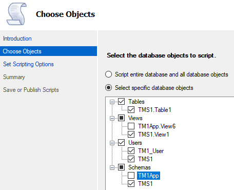

  1. MelissaMa-MSFT 24,221 Reputation points
    2020-10-16T02:00:12.797+00:00
    Hi @Neil ,
    I tried to create a copy of schema in SSMS successfully.
    Please refer below steps and check whether it is helpful to you.
    I have a database named TM1,one schema TMS1,one table TMS1.Table1 and one view TMS1.view1. I would like to copy schema TMS1 and create schema TMS2.
    1. Right click the database
    2. Select Tasks -> Generate Scripts
    3. (Click next if you get the intro screen)
    4. Select "Select specific database objects"
    5. Pick the objects to generate scripts for (tables, stored procedures, etc...)
      List item
    6. Click Next, then check 'save to new query window'
    7. Click Finish to generate the script
    8. In the open query window, you could replace all 'TMS1' with 'TMS2' in the script
    9. Execute this script and schema 'TMS2' is created succesfully together with all objects in this schema.
    Best regards
    Melissa
