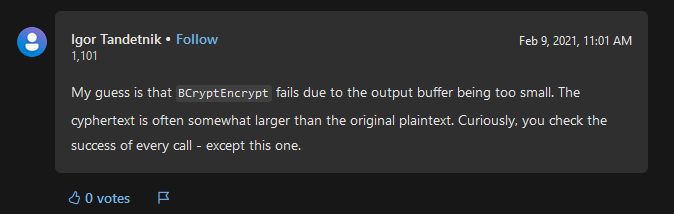

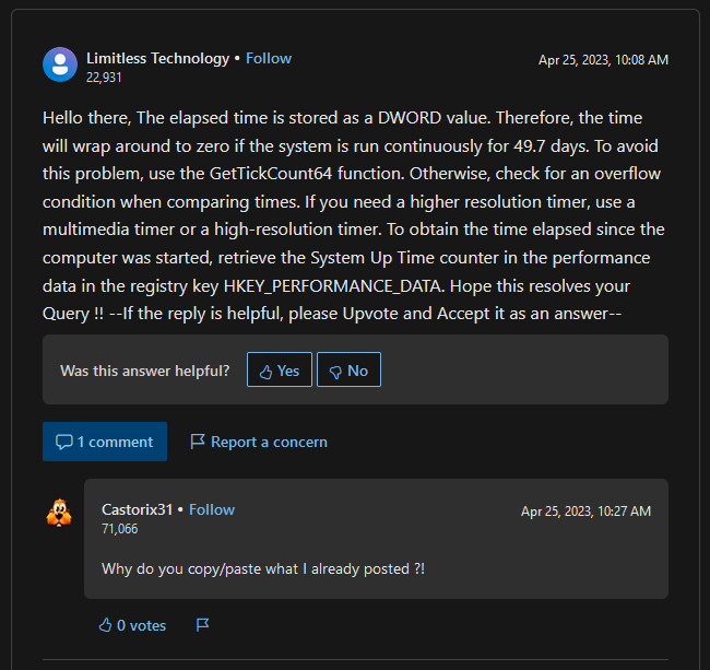

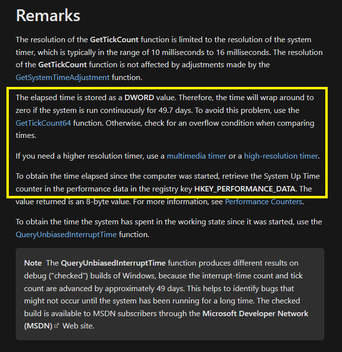

  2. kwikc 136 Reputation points
    2023-05-10T13:24:22.26+00:00
    If that is a word for word copy, I think the forum should have a mechanism to stop shameless posting like that.
