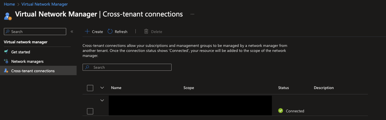

For testing purposes I had a cross tenant connection, however from the target tenant (the one without the Virtual network manager) I am unable to remove the connection. When I remove it the notification tells me it is successfully removed, but it does not disappear from the portal. Refreshed and waited >12 hours.
Screenshot 2023-05-10 at 08.56.09
Screenshot 2023-05-10 at 08.56.02

    A cross-tenant connection can only be established and maintained when both objects from each party exist. When one of the connections is removed, the cross-tenant connection is broken. If you need to delete a cross-tenant connection, you'll perform the following:
    • Remove cross-tenant connection from the network manager side via Cross-tenant connections blade.
    • Remove cross-tenant connection from the tenant side via Virtual network manager hub's Cross-tenant connections blade.
    Note
    Once a connection is removed from either side, the network manager will no longer be able to view or manage the tenant's resources under that former connection's scope.
