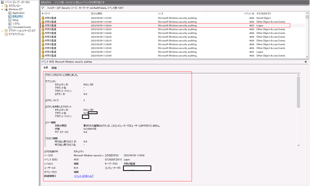

Image of log user normal login
q&a microsoftUntitled

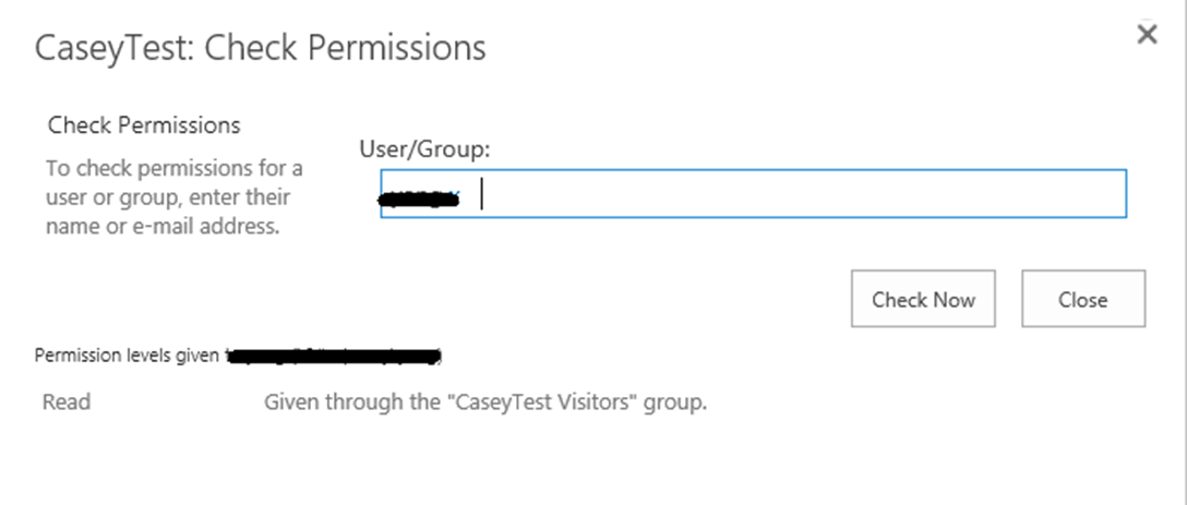

    2. Check if the group have permission to SharePoint. (Settings > Site settings > Site permissions > Check Permissions)

    • Please check whether these users in Group 2 have SharePoint site permissions or not.

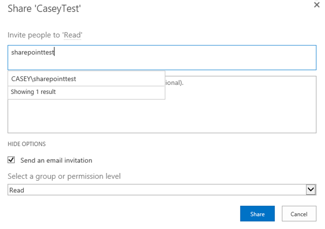

    • You could try to add Group 2 to SharePoint site directly.
    Settings > Site settings > Site permissions > Grant Permissions > Show options > Select "Read" permission level. (Choose the permission you need)
