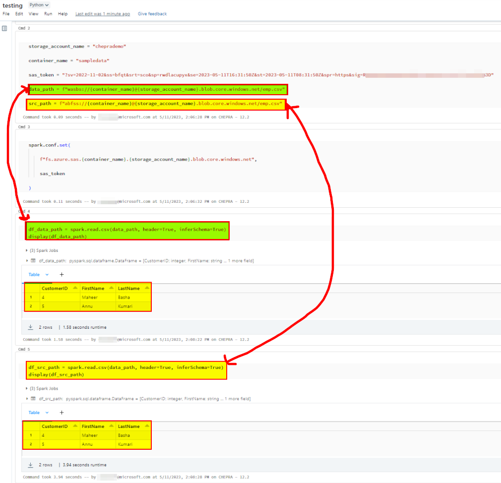

I have tried the below code. It works fine using wasbs. but I am getting error when I tried to read it using abfss
storage_account_name = "newcontainer"
container_name = "source"
sas_token = "mysastoken"
data_path = f"wasbs://{container_name}@{storage_account_name}.blob.core.windows.net/Test/file.csv"
src_path = f"abfss://{container_name}@{storage_account_name}.blob.core.windows.net/Test/file.csv"
Set the necessary configuration for Spark
spark.conf.set(
    f"fs.azure.sas.{container_name}.{storage_account_name}.blob.core.windows.net",
    sas_token
Read data from the Blob container
df = spark.read.csv(data_path, header=True, inferSchema=True)
The above code works fine but If I use abfss ,
df = spark.read.csv(src_path , header=True, inferSchema=True)
I am getting the error: "This request is not authorized to perform this operation using this permission.", 403

  1. PRADEEPCHEEKATLA 91,496 Reputation points Moderator
    2023-05-11T08:45:59.0966667+00:00
    • Thanks for the question and using MS Q&A platform.

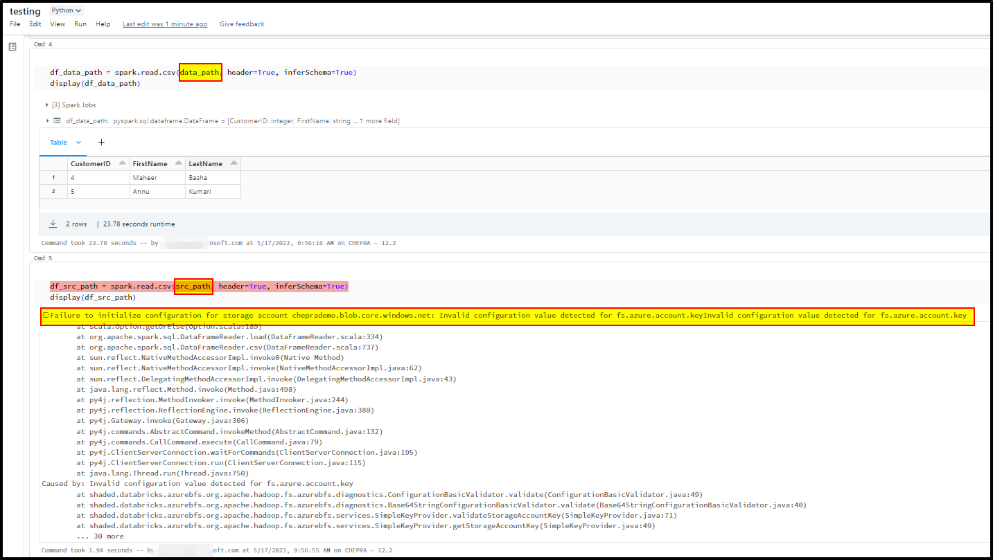

    [UPDATE]: Yes, you are correct. As per the repro - you will experience -
    Failure to initialize configuration for storage account cheprademo.blob.core.windows.net: Invalid configuration value detected for fs.azure.account.keyInvalid configuration value detected for fs.azure.account.key.
    This is a known issue that - you cannot use storage account SAS token to access data using the abfss protocol.
    Reason: You can't use storage account SAS Token to access data using the abfss protocol. You need to provide more configuration options if you want to use abfss - it's all described in documentation.

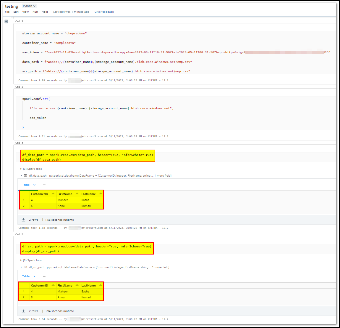

    As per the repro from our end, it's working as expected without any issue as shown below.
    Tested on: Databricks Runtime Version: 12.2 LTS (includes Apache Spark 3.3.2, Scala 2.12)
