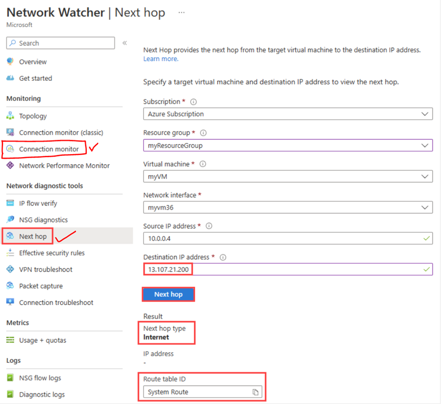

    ·       By the description assuming there is a Tunnel created from Azure to on premise Servers, and Internet traffic exit from the on-premises.
    ·       First check could be to understand what the “Internet” traffic flow from the VM is, and what are the hops involved.
    ·       Please use tools like Next Hop and Connection Monitor from “Network Watcher” which would give more insight on which hop the issue is:User's image
    ·       Document: Tutorial: Diagnose a VM network routing problem - Azure portal - Azure Network Watcher | Microsoft Learn

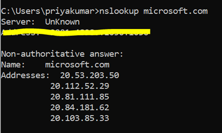

    ·       On the Virtual Machine, please do perform “nslookup” on the source VM, if the URL is resolvable, then issue is not with the DNS. If so then changing the DNS server will not fix the issue.
    For example:User's image
