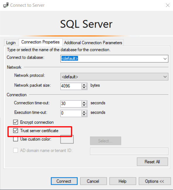

  3. Josef Szeliga 6 Reputation points
    2023-05-15T08:51:02.16+00:00
    Finally found the answer on StackOverflow. Seems that after 2022 Microsoft has started encrypting data between any clients (including SSMS) and the server. On a personal server it's unlikely to find any certificate from a trusted certificate authority.
    So, i just checked this box when connecting to the server.
    If you're using SQL Management Studio, please goto connection properties and click on "Trust server certificated"
    Seems to work fine. Haven't tried connecting with EF yet.
    More here on stackoverflow.
    https://stackoverflow.com/questions/17615260/the-certificate-chain-was-issued-by-an-authority-that-is-not-trusted-when-conn
