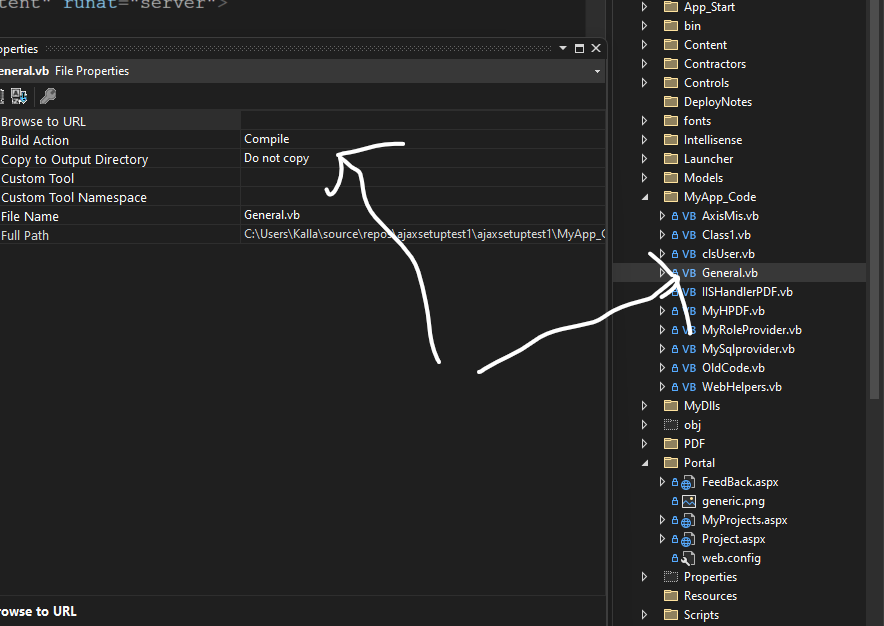

    Now, keep in mind that EACH page requires some changes, but you find a option in the new site called this:
    (and note how this option DOES NOT exist for a web site, but ONLY for a web site application!!!!).

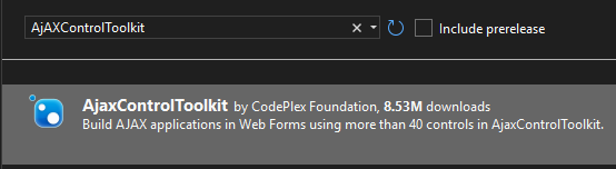

    So, you want to now add the nuget packages.

    However, much will depend on the size and scope of this project. I also suggest creating a folder called MyAppCode, and NOT using App_code.
