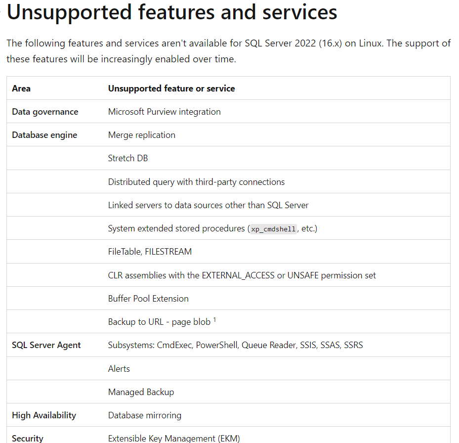

    With that said, I highly recommend to check the official document regarding the limitations for SQL Server 2022 (same doc exists for previous versions) on Linux
    https://learn.microsoft.com/en-us/sql/linux/sql-server-linux-editions-and-components-2022?view=sql-server-ver16&WT.mc_id=DP-MVP-5001699#unsupported-features-and-services

    The answer is yes if you fit the prerequisites :
    Also this link can help you understand and see Known Issues
    https://learn.microsoft.com/en-us/sql/linux/sql-server-linux-release-notes-2022?view=sql-server-ver16
    SQL Server is supported on Red Hat Enterprise Linux (RHEL), SUSE Linux Enterprise Server (SLES), and Ubuntu. It is also supported as a container image, which can run on Kubernetes, OpenShift, and Docker Engine on Linux.
    SQL Server has the following system requirements for Linux:
    Memory2 GBFile SystemXFS or EXT4 (other file systems, such as BTRFS, aren't supported)Disk space6 GBProcessor speed2 GHzProcessor cores2 coresProcessor typex64-compatible onlyIf you use Network File System (NFS) remote shares in production, note the following support requirements:
    • Use NFS version 4.2 or higher. Older versions of NFS don't support required features, such as fallocate and sparse file creation, common to modern file systems.
    • Locate only the /var/opt/mssql directories on the NFS mount. Other files, such as the SQL Server system binaries, aren't supported.
    • Ensure that NFS clients use the 'nolock' option when mounting the remote share.
