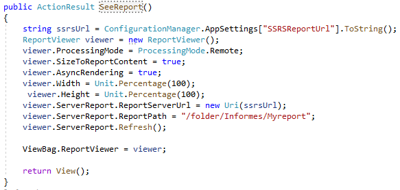

This is my controller:
imagen
And this is the view:
imagen
And I'm getting this error:
Server Error in '/' Application. The request failed with HTTP status 401: Unauthorized. Description: An unhandled exception occurred during the execution of the current web request. Please review the stack trace for more information about the error and where it originated in the code. Exception Details: System.Net.WebException: The request failed with HTTP status 401: Unauthorized. Source Error: An unhandled exception was generated during the execution of the current web request. Information regarding the origin and location of the exception can be identified using the exception stack trace below. Stack Trace: [WebException: The request failed with HTTP status 401: Unauthorized.] Microsoft.Reporting.WebForms.Internal.Soap.ReportingServices2005.Execution.RSExecutionConnection.GetSecureMethods() +192 Microsoft.Reporting.WebForms.Internal.Soap.ReportingServices2005.Execution.RSExecutionConnection.IsSecureMethod(String methodname) +51

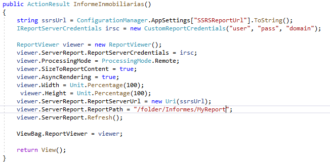

I think this is because of the credentials, so now I'm using this to send the credentials (I guess that domain parameter is the windows domain on the ssrs server pc, right?):
imagen
But I'm getting the error "empty respond":

  2. Ken Taylor 5 Reputation points
    2023-11-07T23:51:02.7133333+00:00
    From what I can tell, all the code above is correct. I implemented pretty much the same code you listed; however, it took me a couple of tries to get things working correctly, and it basically came down to the username, password, and domain name used when creating the CustomReportCredentials. Here are the basics:
    1. First you must have a user, which can also be a local account on the server hosting the Report Server or a domain user account if using Active Directory (AD).
    2. That user must be added and given the "Browse" role on the report directory for which you want them to view the report. This is important. You will find it under "Manage Folder" -> "Security".
    3. You then use that user's username as the "username" field, their password as the "password.
    4. You then enter domain name. For a local account it would the the server (or PC's) name like "myReportServerHost" or whatever. For an AD user it would be the AD domain name like "myAD" or whatever. This was the trickiest part for me, and apparently for others as well based on other articles.
    So the take away is:
    1. Implement the IReportServerCredentials class as you have done above.
    2. Set the appropriate username, password, and domain name.
    3. Add the user, if not already present, to the report server's report directory where the report resides, and configure with a minimum of the browse role.
    4. That should do it.
    I hope someone else finds this useful.
