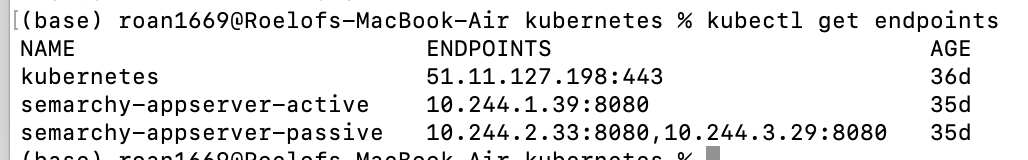

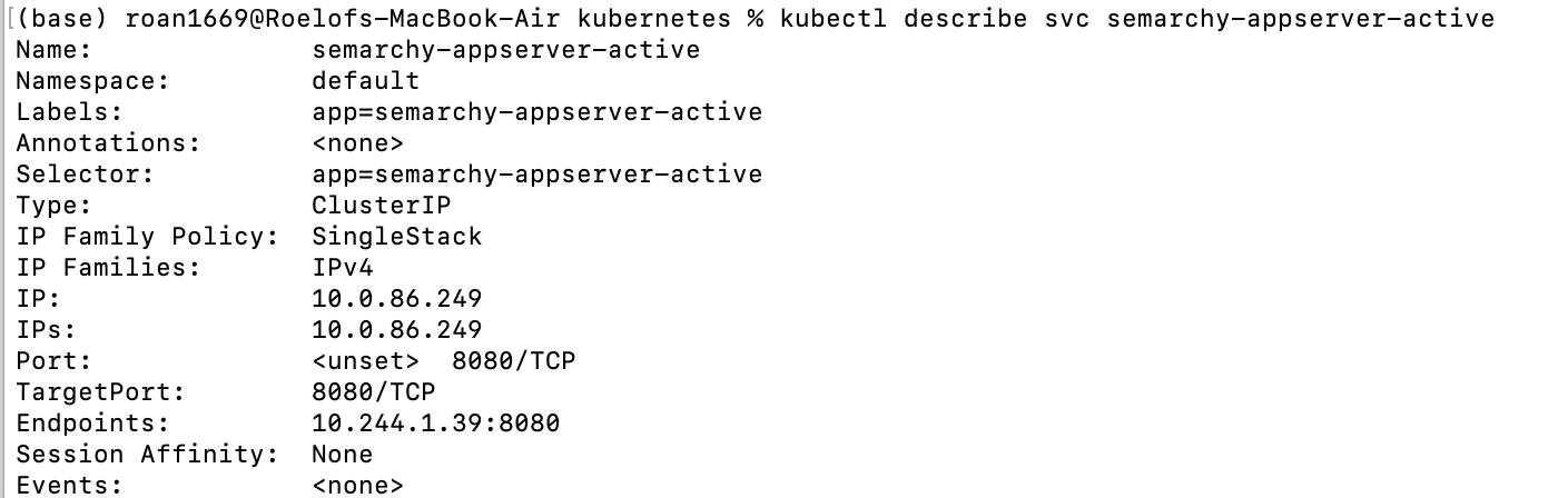

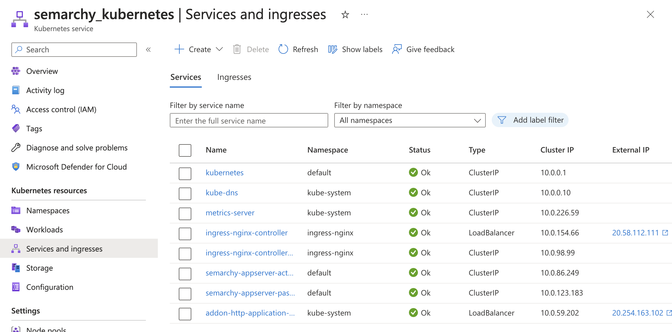

2023-05-17T18:22:33.97+00:00 Thank you again for the help, I have followed your steps and get the below response:
I have also attached screenshots showing the different services that are routed via the load balancer
* Trying 142.250.200.42:80... * Connected to translation.googleapis.com (142.250.200.42) port 80 (#0) > GET / HTTP/1.1 > Host: translation.googleapis.com > User-Agent: curl/7.81.0 > Accept: */* > * Mark bundle as not supporting multiuse < HTTP/1.1 404 Not Found < Date: Wed, 17 May 2023 18:15:56 GMT < Content-Type: text/html; charset=UTF-8 < Server: ESF < Content-Length: 1561 < X-XSS-Protection: 0 < X-Frame-Options: SAMEORIGIN < X-Content-Type-Options: nosniff < <!DOCTYPE html> <html lang=en> <meta charset=utf-8> <meta name=viewport content="initial-scale=1, minimum-scale=1, width=device-width"> <title>Error 404 (Not Found)!!1</title> <style> *{margin:0;padding:0}html,code{font:15px/22px arial,sans-serif}html{background:#fff;color:#222;padding:15px}body{margin:7% auto 0;max-width:390px;min-height:180px;padding:30px 0 15px}* > body{background:url(//www.google.com/images/errors/robot.png) 100% 5px no-repeat;padding-right:205px}p{margin:11px 0 22px;overflow:hidden}ins{color:#777;text-decoration:none}a img{border:0}@media screen and (max-width:772px){body{background:none;margin-top:0;max-width:none;padding-right:0}}#logo{background:url(//www.google.com/images/branding/googlelogo/1x/googlelogo_color_150x54dp.png) no-repeat;margin-left:-5px}@media only screen and (min-resolution:192dpi){#logo{background:url(//www.google.com/images/branding/googlelogo/2x/googlelogo_color_150x54dp.png) no-repeat 0% 0%/100% 100%;-moz-border-image:url(//www.google.com/images/branding/googlelogo/2x/googlelogo_color_150x54dp.png) 0}}@media only screen and (-webkit-min-device-pixel-ratio:2){#logo{background:url(//www.google.com/images/branding/googlelogo/2x/googlelogo_color_150x54dp.png) no-repeat;-webkit-background-size:100% 100%}}#logo{display:inline-block;height:54px;width:150px} </style> <a href=//www.google.com/><span id=logo aria-label=Google></span></a> <p><b>404.</b> <ins>That’s an error.</ins> <p>The requested URL <code>/</code> was not found on this server. <ins>That’s all we know.</ins> * Connection #0 to host translation.googleapis.com left intact

2023-05-23T17:10:01.21+00:00 Hey @Cristian Gatjens ,
Yes I am using a NGINX controller. I have attached the YAML file for you.
kind: Service apiVersion: v1 metadata: name: ingress-nginx-controller namespace: ingress-nginx uid: 24d49316-4f9d-47e3-b35b-e53e0e679e0c resourceVersion: '5570732' creationTimestamp: '2023-04-11T14:49:50Z' labels: app.kubernetes.io/component: controller app.kubernetes.io/instance: ingress-nginx app.kubernetes.io/managed-by: Helm app.kubernetes.io/name: ingress-nginx app.kubernetes.io/part-of: ingress-nginx app.kubernetes.io/version: 1.1.2 helm.sh/chart: ingress-nginx-4.0.18 annotations: kubectl.kubernetes.io/last-applied-configuration: > {"apiVersion":"v1","kind":"Service","metadata":{"annotations":{},"labels":{"app.kubernetes.io/component":"controller","app.kubernetes.io/instance":"ingress-nginx","app.kubernetes.io/managed-by":"Helm","app.kubernetes.io/name":"ingress-nginx","app.kubernetes.io/part-of":"ingress-nginx","app.kubernetes.io/version":"1.1.2","helm.sh/chart":"ingress-nginx-4.0.18"},"name":"ingress-nginx-controller","namespace":"ingress-nginx"},"spec":{"externalTrafficPolicy":"Local","ipFamilies":["IPv4"],"ipFamilyPolicy":"SingleStack","ports":[{"appProtocol":"https","name":"https","port":443,"protocol":"TCP","targetPort":"https"}],"selector":{"app.kubernetes.io/component":"controller","app.kubernetes.io/instance":"ingress-nginx","app.kubernetes.io/name":"ingress-nginx"},"type":"LoadBalancer"}} finalizers: - service.kubernetes.io/load-balancer-cleanup managedFields: - manager: kubectl-client-side-apply operation: Update apiVersion: v1 time: '2023-04-11T14:49:50Z' fieldsType: FieldsV1 fieldsV1: f:metadata: f:annotations: {} f:labels: .: {} f:app.kubernetes.io/component: {} f:app.kubernetes.io/instance: {} f:app.kubernetes.io/managed-by: {} f:app.kubernetes.io/name: {} f:app.kubernetes.io/part-of: {} f:app.kubernetes.io/version: {} f:helm.sh/chart: {} f:spec: f:allocateLoadBalancerNodePorts: {} f:externalTrafficPolicy: {} f:internalTrafficPolicy: {} f:ipFamilies: {} f:ipFamilyPolicy: {} f:ports: .: {} k:{"port":443,"protocol":"TCP"}: .: {} f:appProtocol: {} f:name: {} f:port: {} f:protocol: {} f:targetPort: {} f:selector: {} f:sessionAffinity: {} f:type: {} - manager: cloud-controller-manager operation: Update apiVersion: v1 time: '2023-04-11T14:49:59Z' fieldsType: FieldsV1 fieldsV1: f:metadata: f:finalizers: .: {} v:"service.kubernetes.io/load-balancer-cleanup": {} f:status: f:loadBalancer: f:ingress: {} subresource: status - manager: Mozilla operation: Update apiVersion: v1 time: '2023-04-26T11:58:52Z' fieldsType: FieldsV1 fieldsV1: f:metadata: f:annotations: f:kubectl.kubernetes.io/last-applied-configuration: {} spec: ports: - name: https protocol: TCP appProtocol: https port: 443 targetPort: https nodePort: 32142 selector: app.kubernetes.io/component: controller app.kubernetes.io/instance: ingress-nginx app.kubernetes.io/name: ingress-nginx clusterIP: 10.0.154.66 clusterIPs: - 10.0.154.66 type: LoadBalancer sessionAffinity: None externalTrafficPolicy: Local healthCheckNodePort: 31784 ipFamilies: - IPv4 ipFamilyPolicy: SingleStack allocateLoadBalancerNodePorts: true internalTrafficPolicy: Cluster status: loadBalancer: ingress: - ip: 20.58.112.111
I am installing Semarchy on Kubernetes, please see the link here: https://www.semarchy.com/doc/semarchy-xdm/xdm/5.3/Install/azure/aks/install-on-aks.html
So the app works fine, it is just when I try to enrich data that it fails.
How can I test outbound endpoints through the load balancer?
Also please see attached my ingress controller file
apiVersion: networking.k8s.io/v1 kind: Ingress metadata: annotations: kubernetes.io/ingress.class: nginx nginx.ingress.kubernetes.io/affinity: "cookie" nginx.ingress.kubernetes.io/session-cookie-name: "sticksemarchy" nginx.ingress.kubernetes.io/session-cookie-expires: "172800" nginx.ingress.kubernetes.io/session-cookie-max-age: "172800" nginx.ingress.kubernetes.io/proxy-body-size: 30m name: ingress namespace: default spec: rules: - host: semarchy.passive.912048bebc6c438ea019.ukwest.aksapp.io http: paths: - backend: service: name: semarchy-appserver-passive port: number: 8080 path: / pathType: Prefix - host: semarchy.active.912048bebc6c438ea019.ukwest.aksapp.io http: paths: - backend: service: name: semarchy-appserver-active port: number: 8080 path: / pathType: Prefix
Please also see attached a screenshot of the deployed application.

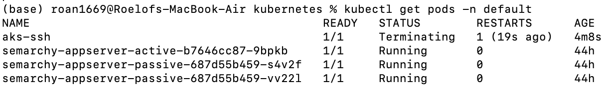

Roan van Heerden • 0 Reputation points
2023-05-24T13:16:27.54+00:00 I tried:
curl -vvv <LB_IP>:Port
And got this response:
root@aks-ssh:/# curl -vvv 20.58.112.111:443
* Trying 20.58.112.111:443...
* Connected to 20.58.112.111 (20.58.112.111) port 443 (#0)
