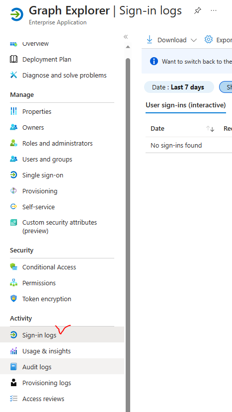

    Can you share more for example ehat do we see in Azure Sign In Logs ?
