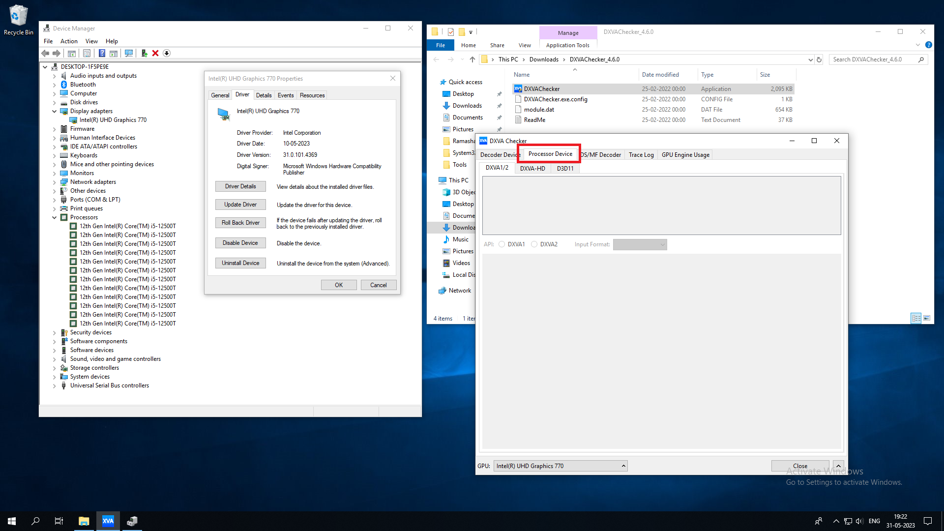

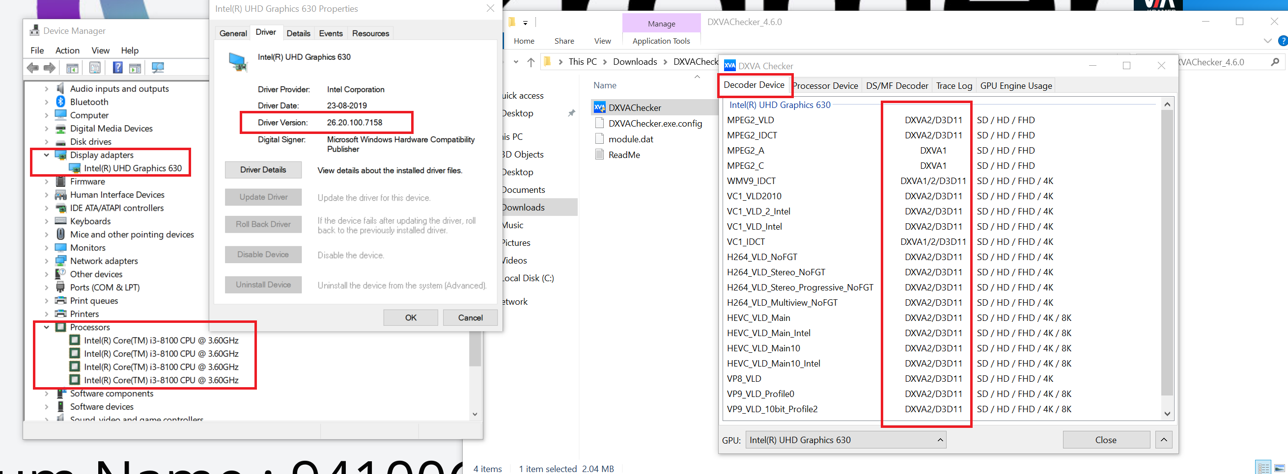

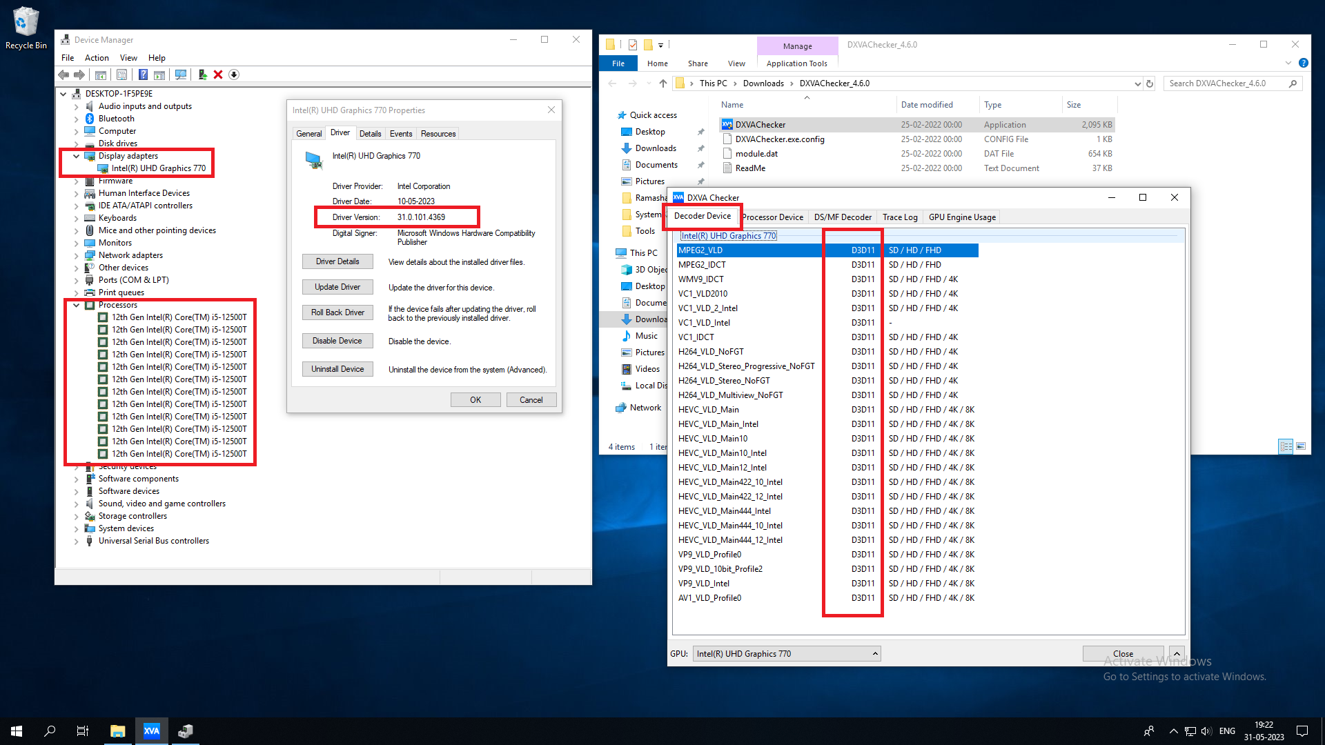

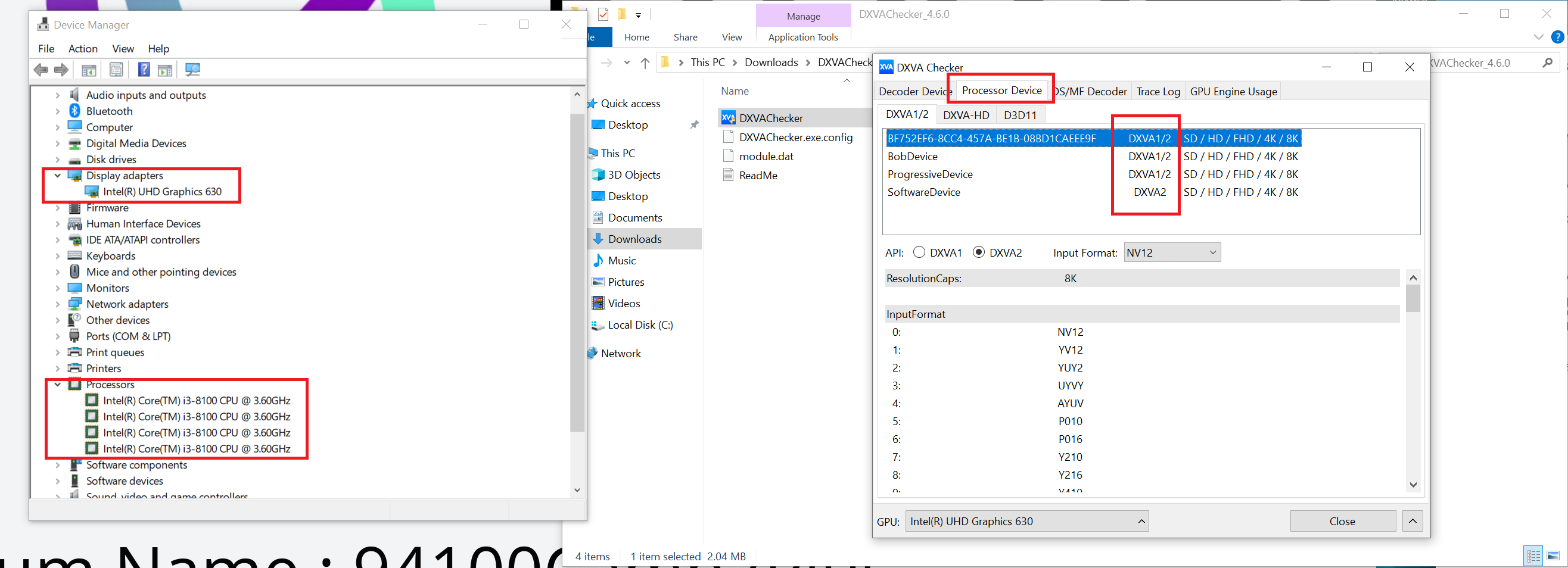

    While debugging EVR issue further, I came across a tool called DXVA Checker (https://bluesky-soft.com/en/DXVAChecker.html)) which tells you about DXVA support on pc.
    This tool is showing NO SUPPORT for DXVA on PC2 (i5-12th Gen pc) when intel driver is installed, and shows software version support when intel driver is uninstalled. Refer images: i5-12Gen_Intel_DXVA_Issue_1.png, i5-12Gen_Intel_DXVA_Issue_2.png, i5-12Gen_Microsoft_DXVA_OK_1.png, i5-12Gen_Microsoft_DXVA_OK_2.png
    Then, I used this tool on PC1 also (i3-8th Gen) which works fine for EVR scenarios. Here this tool is showing full support of DXVA with intel driver too. Refer images: i3-8Gen_DXVA_OK_1.png, i3-8Gen_DXVA_OK_2.png.
     With this observation, I believe this DXVA support has something to do with EVR issue.
    As I am not aware of whose responsibility is to support DXVA on pc, whether it is Windows OS or intel GPU hardware or intel graphics driver, so can anyone clarify this? Since same OS is working fine with other intel CPU/GPU hardware so I don't have doubt on OS.
    Do I need to install any thing more (any OS component/modules or intel software/driver) on PC2to fix this issue?
