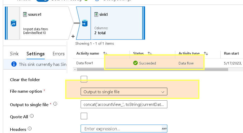

Within the sink settings I have the following configured:
Output to a single file for which the file name is being dynamically assigned as follows:
concat('accountView_', toString(currentDate()), '.csv')

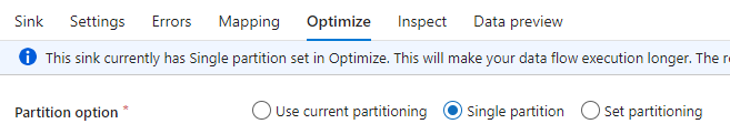

Under the Optimize tab:

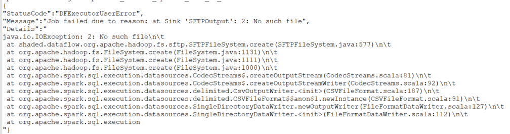

However, as of yesterday all pipelines have started to fail with the following error:

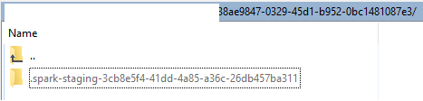

When re-running the failed task I notice that some folders are created on the SFTP:
There are few other folders contained within but I was not able to capture all of them. I think they named something like .temporary/0
When the pipeline fails these folders are no longer present on the SFTP.

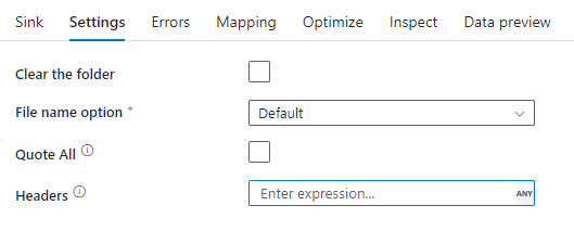

From the testing I have done so far (which is mainly with adjusting the settings with the sink). I've noticed that the pipeline will now only succeed with the following settings:
None of the other options under "File name option" or "Partition option" seem to be working.
If any other setting is selected, the pipeline will fail with the same error message as shared above.
