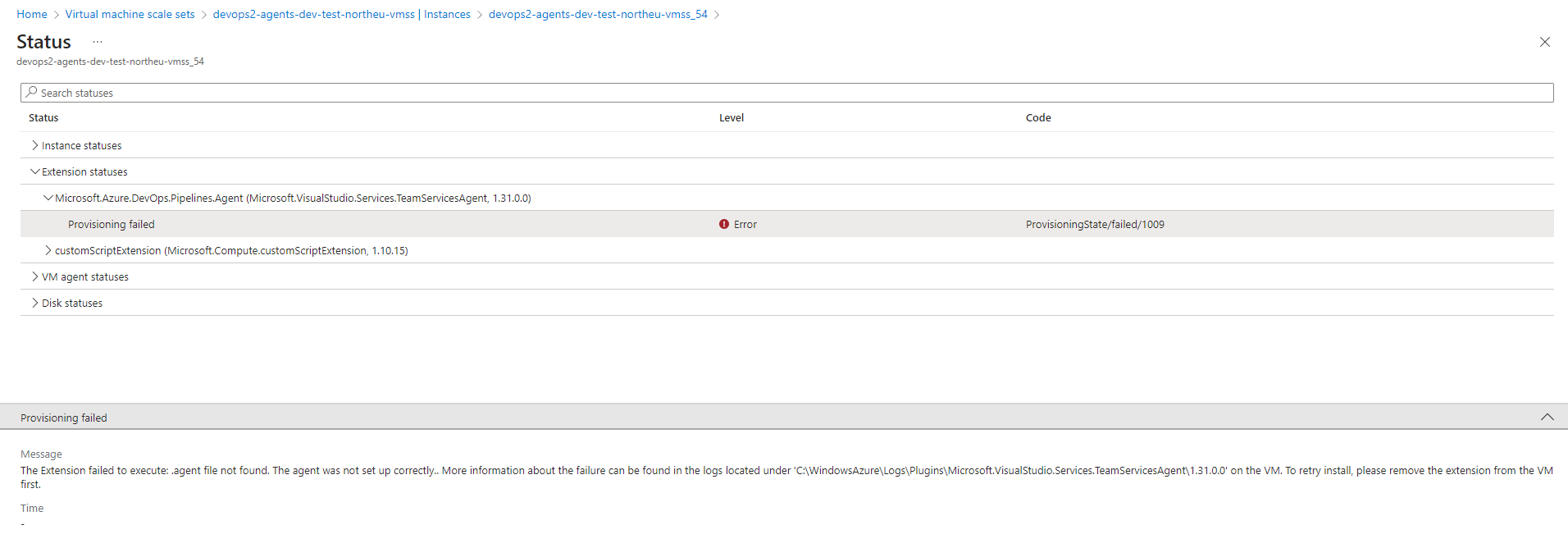

Azure VM. The extension failed to execute: .agent file not found
Ruslan Burnashev 5 Reputation points
2023-05-17T11:03:20.85+00:00
We have Azure Virtual machine scale set working as pipeline agent pool. This error may appear on any new pipeline run. And after it happens once it happens on all subsequent runs.
Recreating agent pool or vm scale set fixes the issue. Restarting or reimaging vm do not help.
MicrosoftTeams-image
