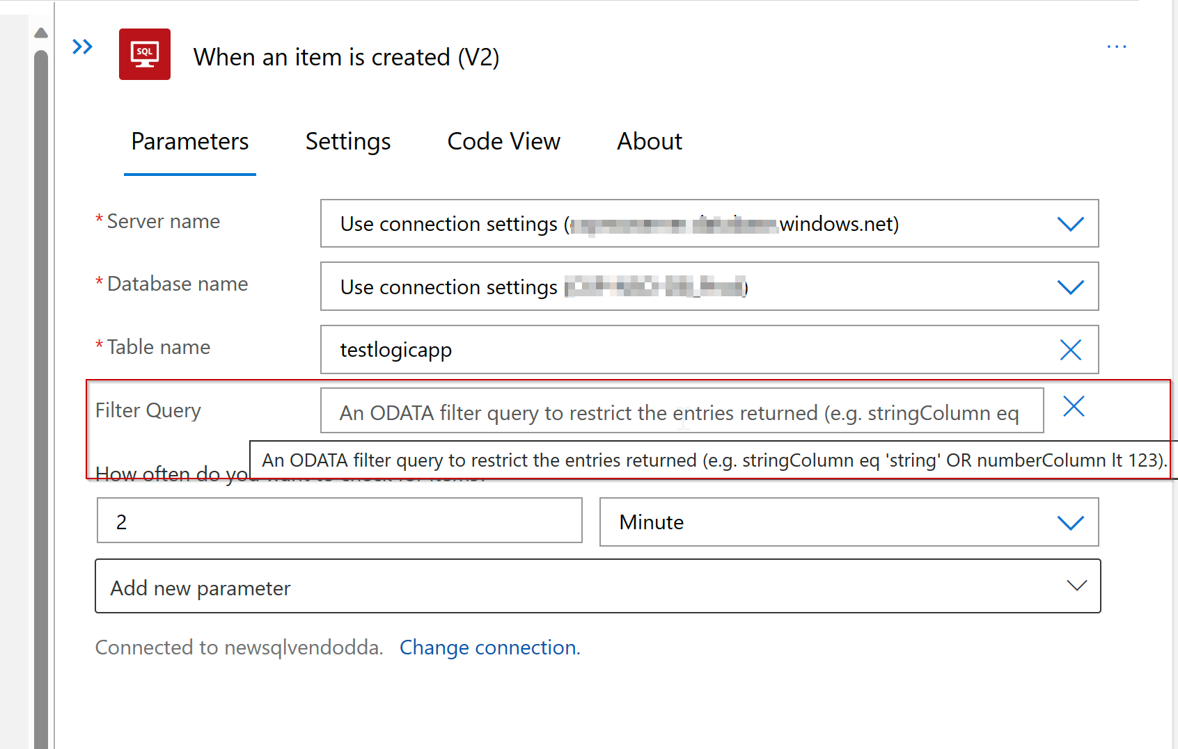

  1. VenkateshDodda-MSFT 25,111 Reputation points Microsoft Employee Moderator
    2023-05-18T10:56:20.2633333+00:00
    @R13 Thank you for reaching out to Microsoft Q&A, apologize for any inconvenience caused on this.
    Based on the shared information, we have understood that in your logic app workflow you are using When_an_item_is_created_(V2) as trigger and you what to filter the records which has FundName = 'REDACTED' in the same step only using where condition.
    • You cannot pass any condition to Select Query parameters, select query parameter is to list the output columns that you want to see in the query output.
    • You need to use Filter Query parameter to filter the data by using ODATA filter query as shown below.
    Before using the filter query just make sure your logic app is getting triggered when a new item got inserted into the sql server.
    For more information, you can go through the Azure SQL server connector documentation.
