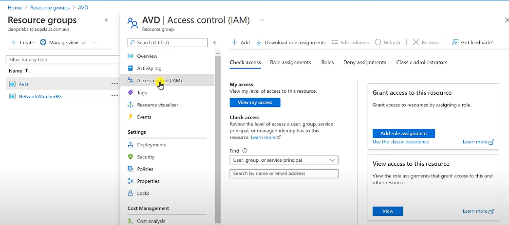

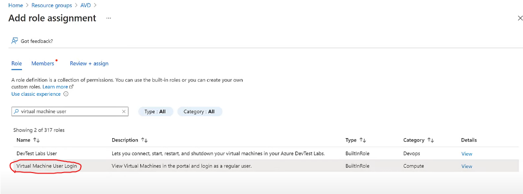

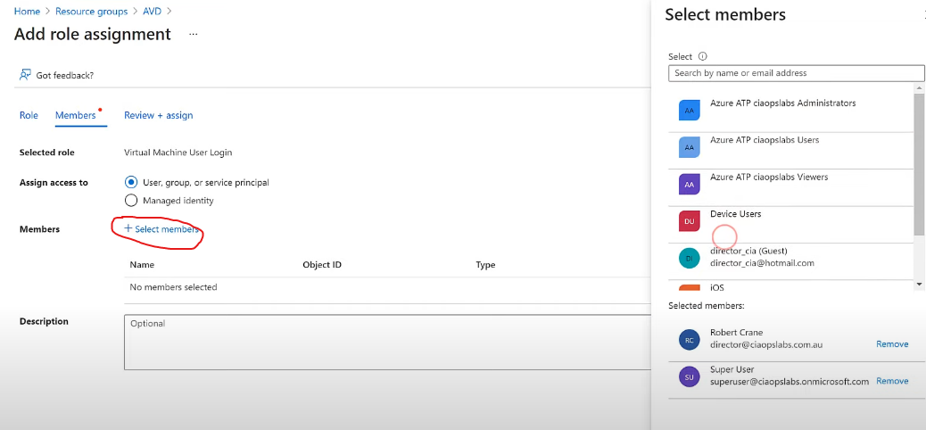

  1. William Clay 1 Reputation point
    2023-05-17T19:01:17.61+00:00
    Hello,
    Can you verify if you have assigned users (your test user) to an application group within the host pool?
    https://learn.microsoft.com/en-us/azure/virtual-desktop/create-application-group-workspace?tabs=portal#assign-users-to-an-application-group
    You will also need to give users permission to sign into AVD. This is easily done at the resource level.
    Here is a link to a YouTube video that may help.
    https://youtu.be/jMAanEp-ugI
