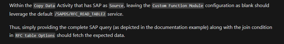

Assumption:
Within the Copy Data Activity that has SAP as Source, leaving the Custom Function Module configuration as blank should leverage the default /SAPDS/RFC_READ_TABLE2 service.
Thus, simply providing the complete SAP query (as depicted in the documentation example) along with the join condition in RFC table Options should fetch the expected data.
