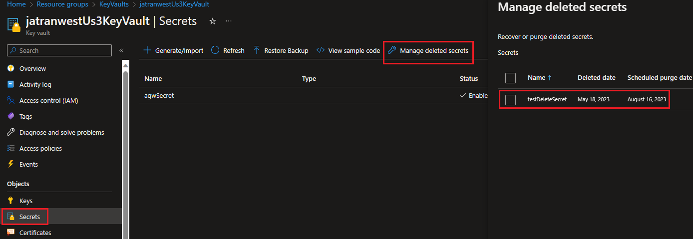

    I understand that you were trying to setup a scaling plan for your VM and ended up deleting the scaling plan, which could've caused the error message above. Since you confirmed your KV is enabled for Volume Encryption and the Secret your VM is trying to retrieve doesn't exist, can you share some more details so I can gain a better understanding of your issue.
    • Was your VM working with Azure Disk Encryption prior to creating/deleting the scaling plan?
    • Can you ensure that after deleting the scaling plan, your VM still has the correct Access Policy permissions to retrieve the KV Secret?
    • Within your prod-moodkv Vault under the Secrets page, select "Manage deleted secrets" to ensure the Secret isn't in a delete state and can be restored.

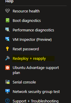

    1. Redeploy the Virtual Machine: If the previous step does not resolve the issue, consider redeploying the VM. This will create a new instance of your machine on new server hardware in Azure, which can help solve intermittent or hard-to-diagnose issues.
