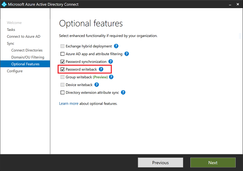

    So , Password Write-back is enabled right ?
    Configure Azure AD Connect for password writeback

    If you don't see it enabled please check this on Azure :
    Azure AD - Password Reset - On Premises Integration - Password Writeback
    I suggest also to read this and take the appropriate steps to configure it correctly
    https://learn.microsoft.com/en-us/azure/active-directory/authentication/tutorial-enable-sspr-writeback?WT.mc_id=Portal-Microsoft_AAD_IAM#configuring-password-writeback

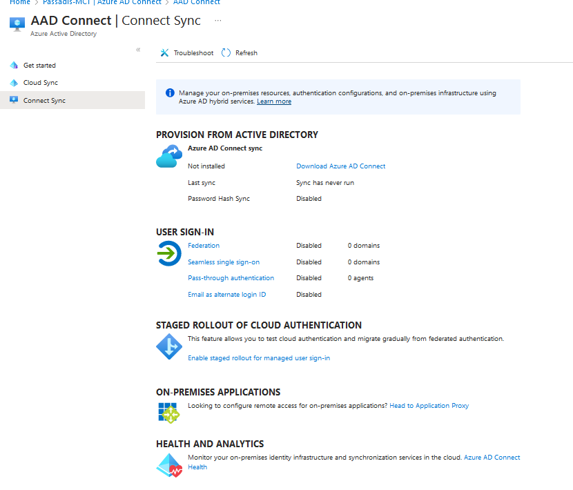

    Finally how is this looking on your Tenant :
    Waiting for your feedback !

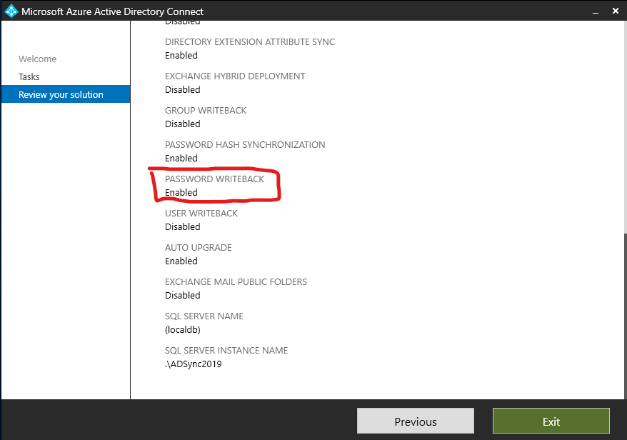

  5. Khord T 0 Reputation points
    2023-05-19T19:01:07.82+00:00
    Thank you for all that!
    As the screenshot below shows, we do have Password Writeback enabled:
    I'm perhaps a little confused on why this one would matter at all though. Please forgive me on this one, I'm not saying you're wrong at all, just my personal ignorance on the subject. Password writeback should only matter for user passwords on the domain correct? The users are in Windows AD, the computers aren't. Would this just take the users Azure AD password and write it back to Windows AD as their user account password?
