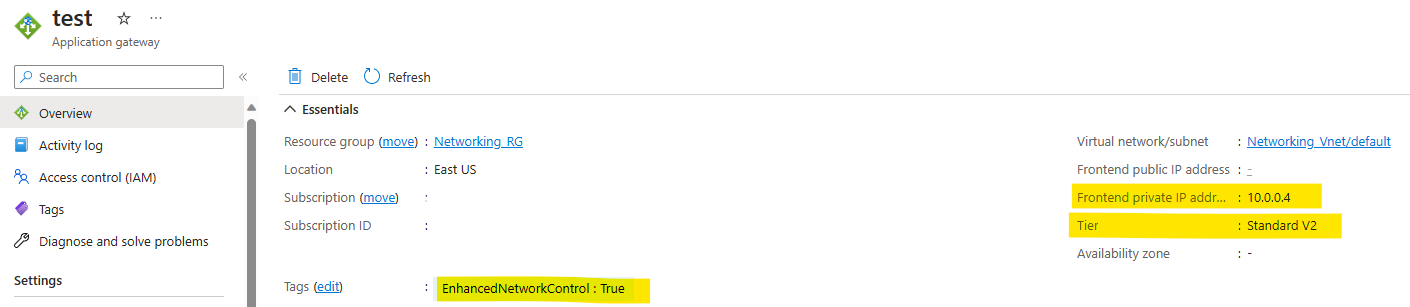

    I understand that you are trying to create an Azure Application Gateway V2 with private IP only but even after registering for the "EnableApplicationGatewayNetworkIsolation", you are getting the following error: "Application Gateway <id> does not support Application Gateway without Public IP for the selected SKU tier Standard_v2. Supported SKU tiers are Standard,WAF. Error code: ApplicationGatewayFeatureCannotBeEnabledForSelectedSku".
    I tried to replicate it in my lab but was able to create an Application gateway v2 with private IP only successfully.
    enter image description here
    Regarding your question "This subnet has previously had other Standard_v2 Application Gateways deployed before the feature was enabled (they have been removed). Is it possible that the subnet has to be re-created to support the new gateway feature?", there is a FAQ available in the below doc:
    https://learn.microsoft.com/en-us/azure/application-gateway/application-gateway-private-deployment?tabs=portal#coexisting-v2-application-gateways-created-prior-to-enablement-of-enhanced-network-control
    And it says:
    Application gateways provisioned prior to enablement of the new functionality must either be reprovisioned, or newly created gateways must use a different subnet to enable enhanced network security group and route table features.
    So, my suggestion would be to create a new subnet and try the deployment again.
