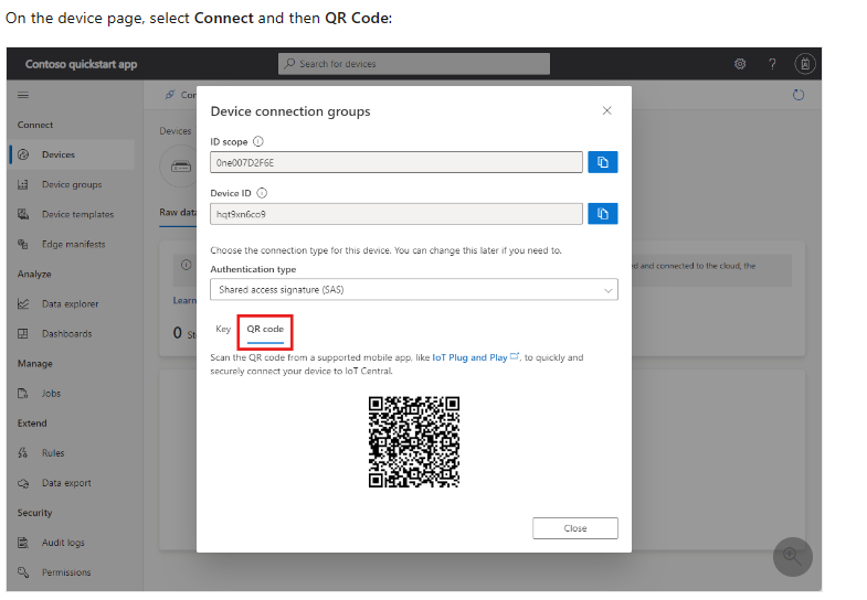

    Could you please confirm how exactly you have added the device?
    If your device is showing as "Registered" but not "Provisioned" in Azure IoT Central, it means that the device has successfully connected to the IoT Central application, but has not yet been provisioned with the necessary credentials to communicate with the IoT Hub.
    To provision the device, you need to create a device template in IoT Central that defines the device capabilities and properties, and then associate the device with the template. Once the device is associated with the template, IoT Central will generate the necessary credentials and configuration information for the device to connect to the IoT Hub.
    Please see IoT Central device connectivity guide for more details.
