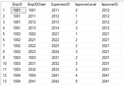

    Output:

  1. elsvieta 371 Reputation points
    2023-05-30T15:49:08.2133333+00:00
    Erland Sommarskog,
    thank you for your answer. The updated Approver ID refers to the EmpID column, therefore the update version of the column is stating, correctly, that 2012 is the Approver of 1001. It is confusing, but I need the data this way because the reporting tool would not work with anything else.
