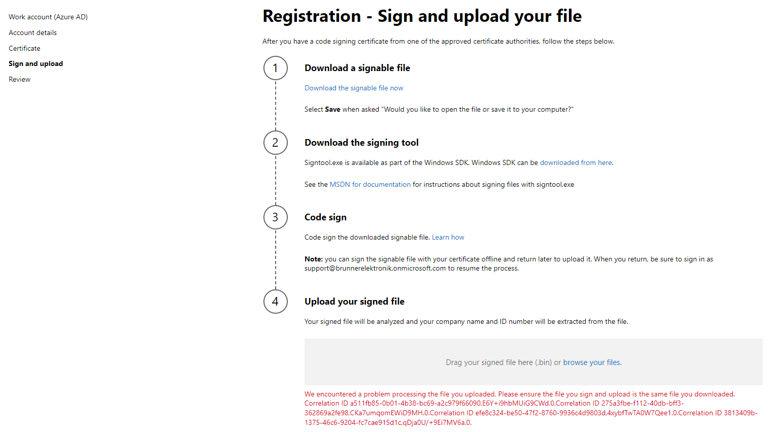

When I try to register to Hardware Development Program the upload of the SignableFile.bin always fails, here is what I do and see:
  1. Download the SignableFile.bin
  2. I sign this file with my EV Certificate
  3. I try to upload the file and I get this error message:
We encountered a problem processing the file you uploaded. Please ensure the file you sign and upload is the same file you downloaded.
Correlation ID a5ab1afc-9d5e-4dba-a3f3-dd7a95f47111,JRAPkUSP2kqQlzhj.0.
On the Console of the browser I see:
POST https://partner.microsoft.com/en-US/dashboard/Registration/Hardware/HardwareRegistrationCertificateCheck 500
o @ partner.min.js:1
XMLHttpRequest.send @ ai.min.js:1
send @ jquery-2.1.1.min.js:4
ajax @ jquery-2.1.1.min.js:4
PostForm @ Hardware?step=SignUpload:671
OnChange @ Hardware?step=SignUpload:714
onchange @ Hardware?step=SignUpload:797
Seems to me the server is failing with an unexpected error and returns a 500.

    On the webpage
    https://partner.microsoft.com/en-us/dashboard/Registration/Hardware?step=SignUpload
    I also got the error message:
    In the end, I signed my file wrongly.
    My main problem was that the /ac commandline parameter was missing.
    The command that worked for me for signing the file SignableFile.bin is
    signtool.exe sign /v /fd sha256 /ac "<PATH TO ROOT CERTIFICATE G2 .cer FILE>" /s my /n "<ISSUED TO NAME OF YOUR USER CERT>" /t http://timestamp.digicert.com .\SignableFile.bin
    Good luck to any future reader

    We have the same problem.
    On registering as hardware partner when signing the test file SignableFile.bin the uploaded file is rejected.
    We can sign the file using the following commandline:
    signtool.exe sign /tr http://timestamp.digicert.com /td sha256 /fd sha256 /n "<ISSUED TO NAME HERE>" .\SignableFile.bin
    But the Registration website rejects the file with the following error message:

    Hi, we have the dame issue since months. @Limitless Technology the problem is even before uploading a driver. It is while the registration process, where you download a SignableFile.bin --> sign it --> and upload it again, then this error message is shown "We encountered a problem processing the file you uploaded. Please ensure the file you sign and upload is the same file you downloaded."
