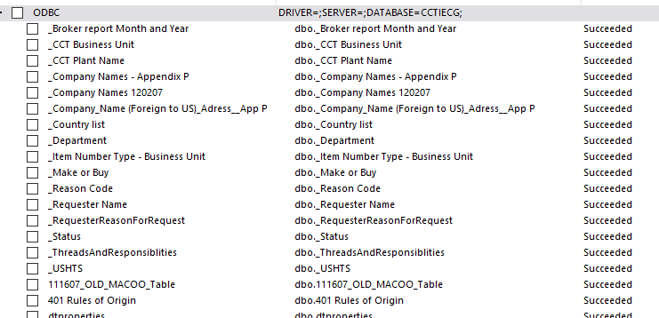

I am trying to run a code that would update a table on an sql server. When doing this, I get an error seen below.
Ive tried relinking the tables from the SQL server and they are all good so Im not sure what the error is.
