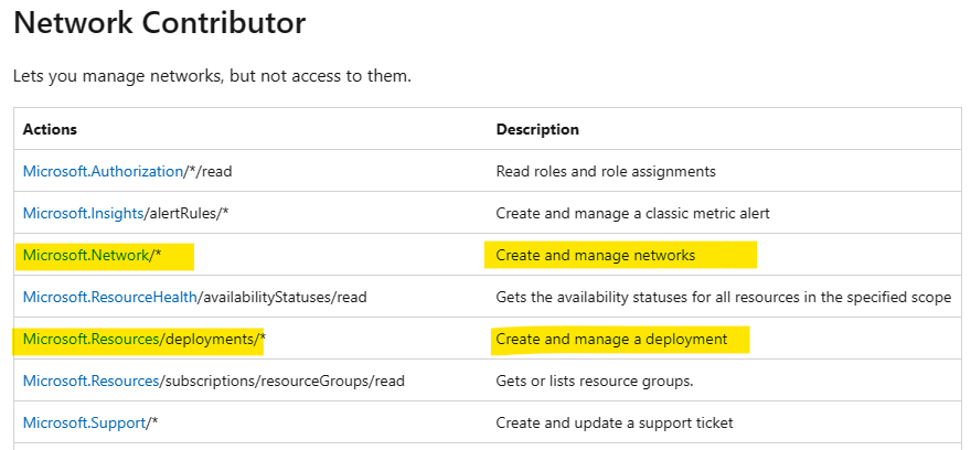

    No, assigning a user with the "Network Contributor" role on a load balancer in Azure does not grant them the ability to add backend virtual machines (VMs) to the load balancer.
    The "Network Contributor" role provides permissions to manage network resources such as virtual networks, subnets, network interfaces, and IP addresses. While it does grant certain permissions related to load balancers, such as managing load balancing rules and probes, it does not provide the necessary permissions to add or modify backend VMs associated with the load balancer.

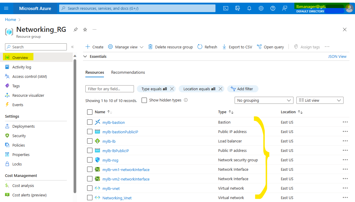

    enter image description here

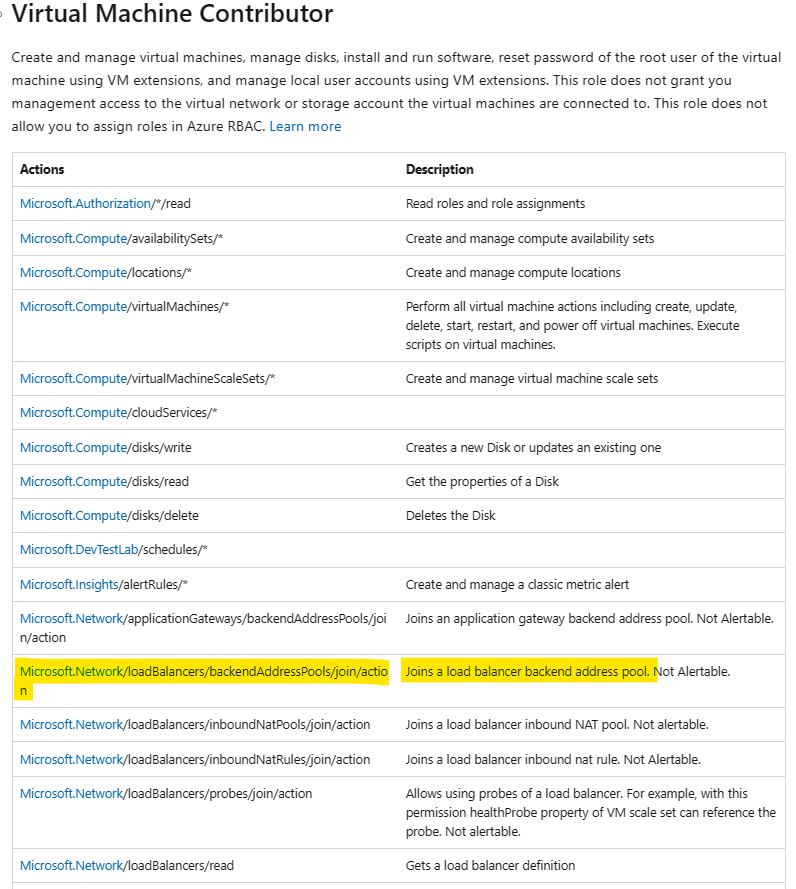

    To add backend VMs to a load balancer, the user would require additional permissions, specifically the "Virtual Machine Contributor" role or higher. The "Virtual Machine Contributor" role grants the necessary permissions to manage virtual machines, including the ability to add, modify, and delete VMs.

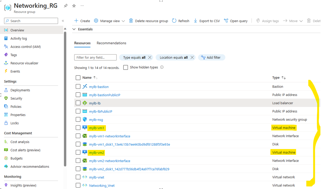

    Therefore, to allow a user to add backend VMs to a load balancer, you would need to assign them the "Virtual Machine Contributor" role or a role that includes it, such as the "Contributor" or "Owner" roles.

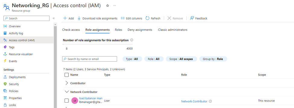

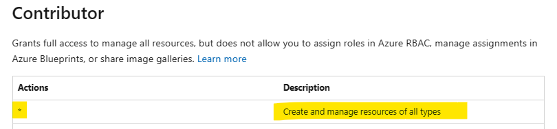

    The "Contributor" role provides full access to all resources, including the ability to create, read, update, and delete resources but does not grant permissions to manage access control.

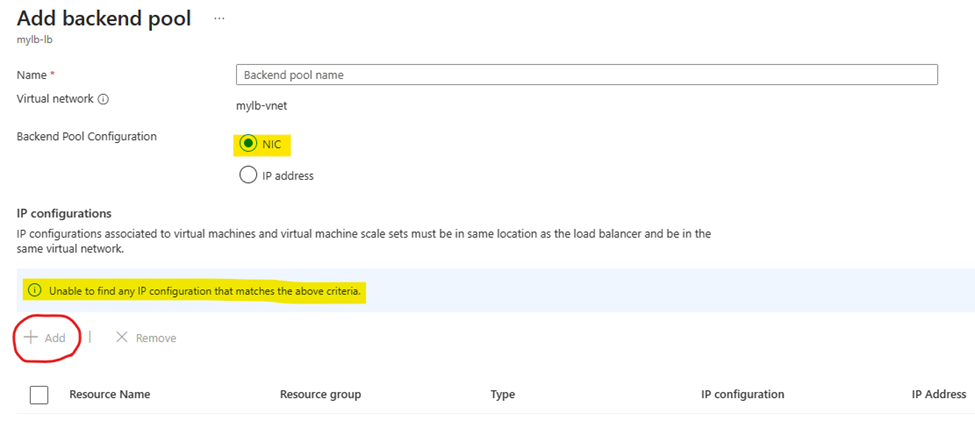

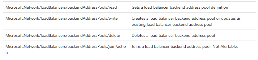

    In addition to the "Contributor" role, you can create a custom role with specific permissions to add a backend pool to a load balancer. The custom role should have the following permissions:
    • Microsoft.Network/loadBalancers/backendAddressPools/read
    • Microsoft.Network/loadBalancers/backendAddressPools/write
    • Microsoft.Network/loadBalancers/backendAddressPools/delete
    • Microsoft.Network/loadBalancers/backendAddressPools/join/action
    These permissions allow the user or role to read, create, delete, and modify backend address pools within the Azure Load Balancer.
