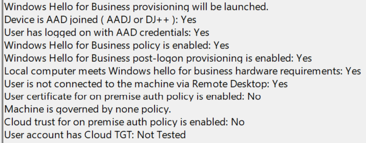

Looking at the User Device Registration logs, it appears that the policy is not applying and the browsing of OnPrem shares is not working.
Event Log 358
Windows Hello for Business provisioning will be launched.
Device is AAD joined ( AADJ or DJ++ ): Yes
User has logged on with AAD credentials: Yes
Windows Hello for Business policy is enabled: Yes
Windows Hello for Business post-logon provisioning is enabled: Yes
Local computer meets Windows hello for business hardware requirements: Yes
User is not connected to the machine via Remote Desktop: Yes

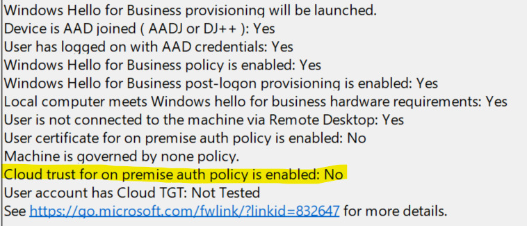

User certificate for on premise auth policy is enabled: No
Machine is governed by none policy.
Cloud trust for on premise auth policy is enabled: No
User account has Cloud TGT: Not Tested

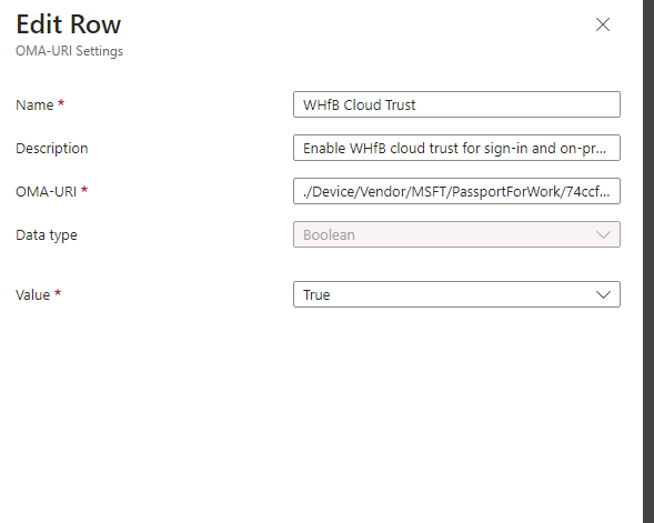

    Also, verify that the tenant ID and the rest of the OMI URI is correct.
