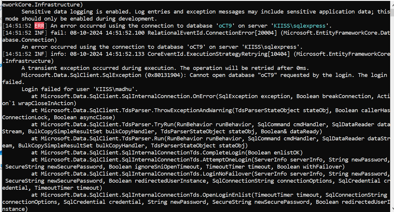

  5. MADHUSUDHAN V 0 Reputation points
    2024-10-08T09:29:42.63+00:00
    Am facing it recently for localhost & code first migration, i tried changing to Encrypt,TrustCerticate all but nothing worked. So for me last option was,create db using Update-migration and then continue using same connection string as earlier. everything become fine.
    Error:User's image
    Solution:
    Step1:User's image
    Step2:Use assusual connection string.
