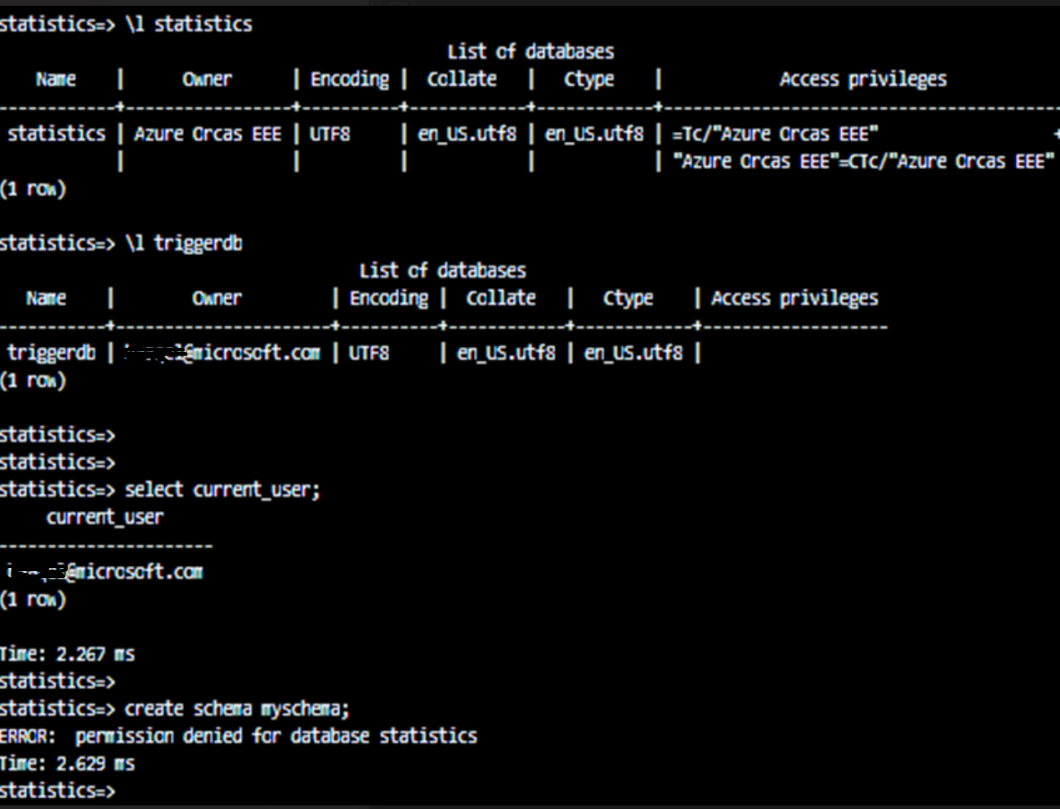

I created a new Azure Postgresql - Flexible server and attached Azure Ad admin. then created a new DB on that server. Now when logging through the Azure Ad Admin and running create schema command on the new DB, getting below error
permission denied for database
In the single server, the Azure Ad admin had the admin rights.

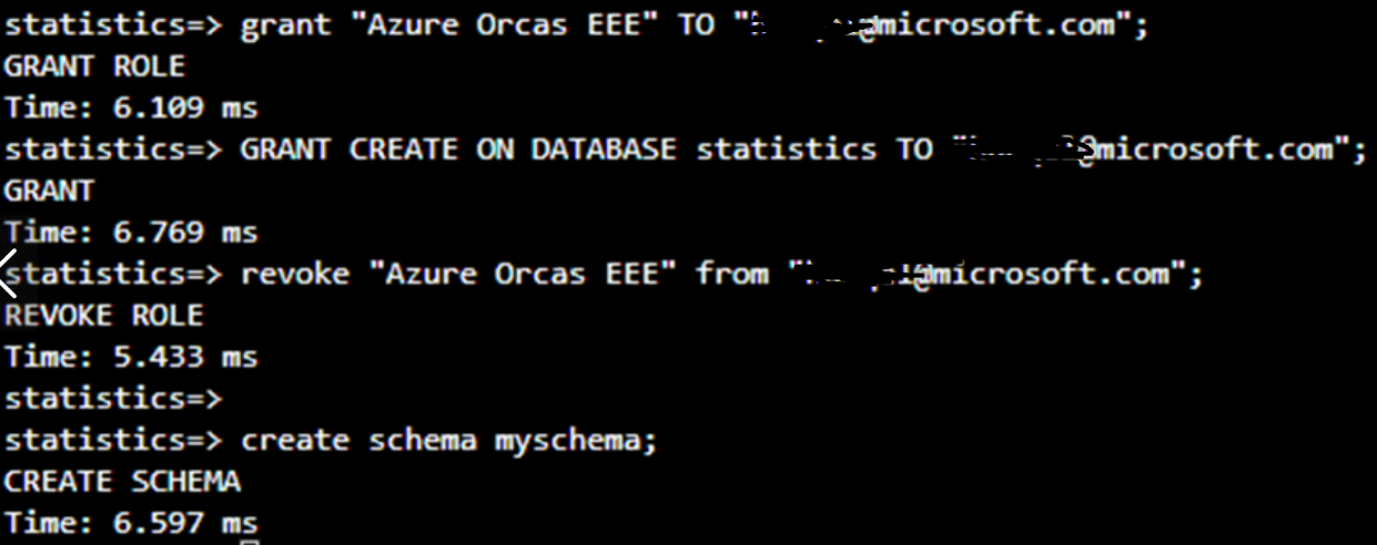

    This is expected behavior, you can take a look below
    If you want to do that, as long as you have the required permissions as Admin, you can assign the role owner of that database to your role, and grant the permission to create a schema to that target user, as in the below example:
    I hope this information helps
