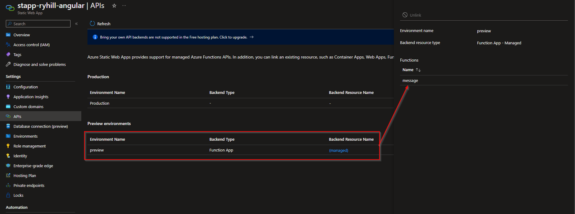

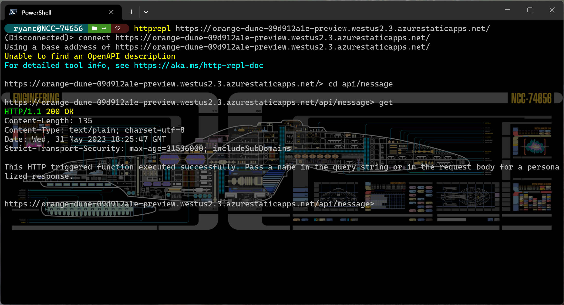

  3. Ryan Hill 30,281 Reputation points Microsoft Employee Moderator
    2023-05-23T21:33:01.1833333+00:00
    @Christopher Moskovitz
    Managed API defaults to /api/functionname. The platform will automatically forward requests to that endpoint. If you're getting 404s, the only thing I can think of is your you never updated the output dir for your deployment.
    Using swa cli, this is the --api-location argument. In yaml, it's the api_location argument. Try http repl to https://<swa-host-name>.staticwebapps.net/api/functionname to call the endpoint directly to confirm.
