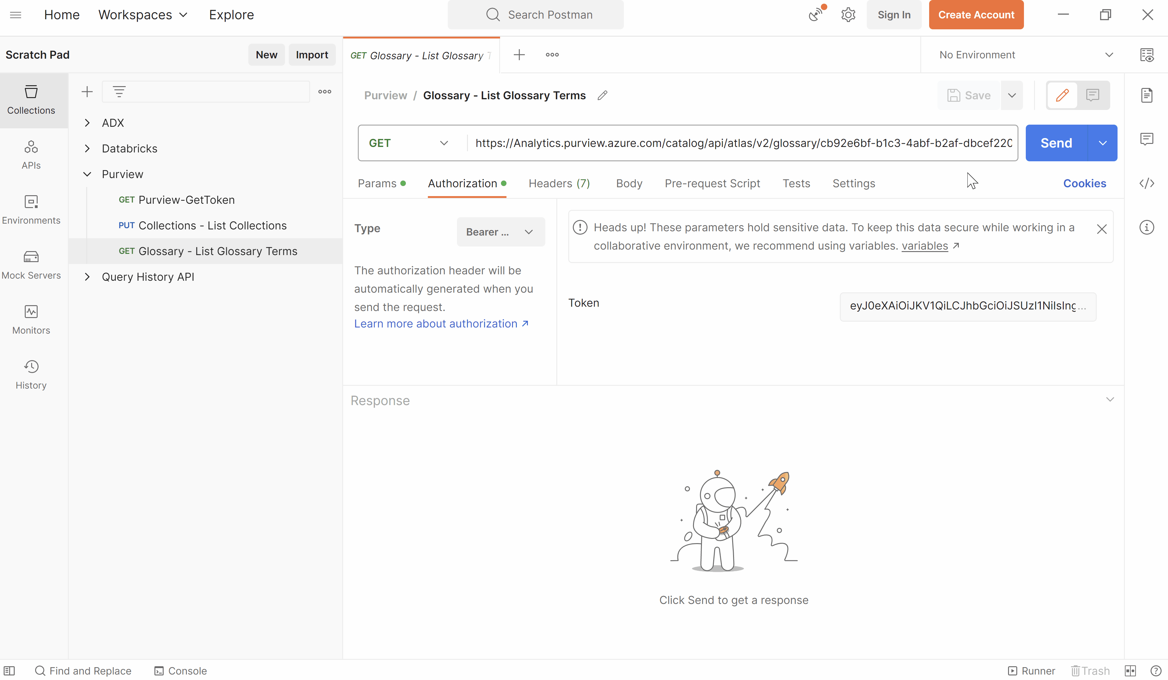

  1. PRADEEPCHEEKATLA 91,581 Reputation points Moderator
    2023-05-29T06:45:50.4166667+00:00
    @Jadhav, Karan - Thanks for the question and using MS Q&A platform.
    There could be two reason, for the above issue - you are using the expired access_token or the client_secret has been expired. Make sure to validate both and see if that works.
    As per the repro from my end, I was experiencing the same issue because I was using the access_token which is generated on the last use (almost a month ago).
    When I replaced with the new access_tokenwith a newer access_token it working as excepted.
    MSPurviewRestUpload
    There could be another issue which would leads to this error message, that can be client_secret expired. Make sure that you have a valid client_secret incase, if it expired try to create a new client_secret and re-generate the token.
    Hope this helps. Do let us know if you any further queries.
