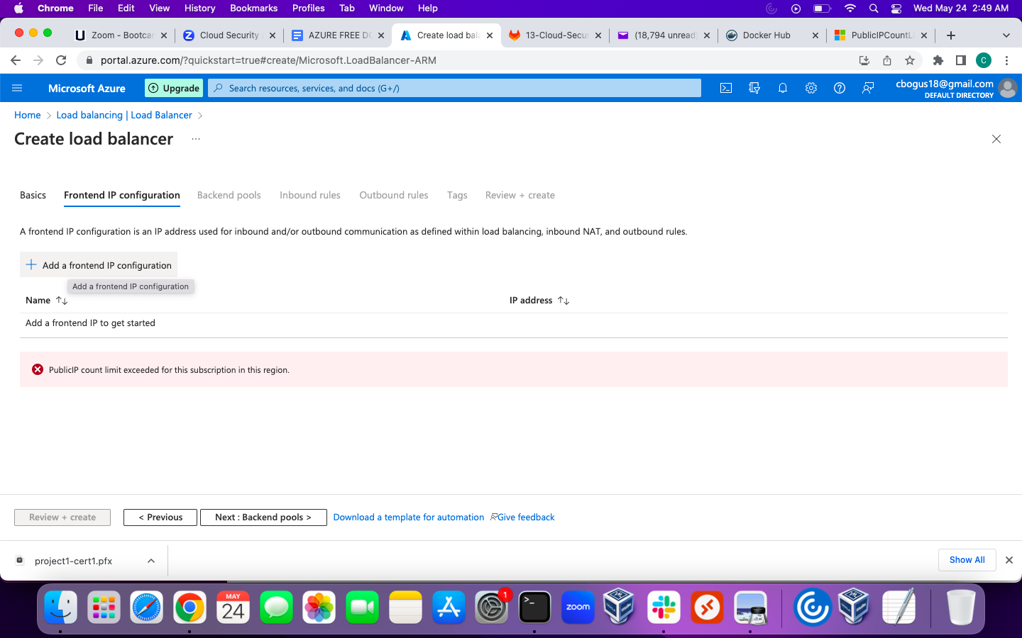

How to fix "publicip count exceeded for this subscription in this region" error?
cbogus18 20 Reputation points
2023-05-24T18:09:00.4666667+00:00
How Do I fix this?

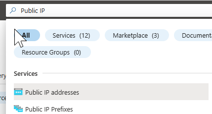

    2. Search for "Public IP addresses".

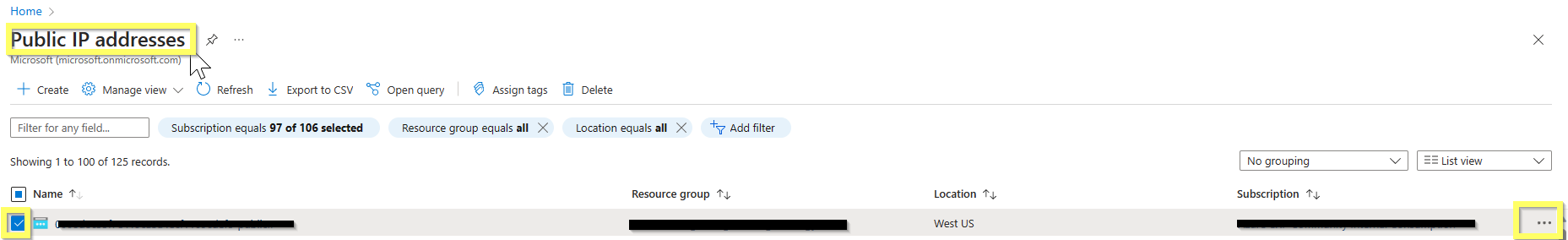

    3. Select the public IP address that you want to delete.
    4. Click on the three dots on the right side.
    5. Confirm that you want to delete the public IP address.
