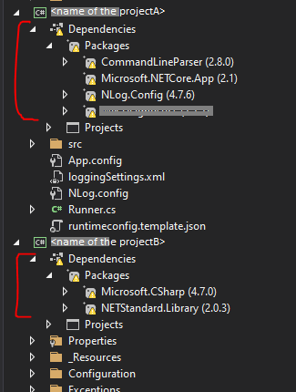

1.a) When I opened the solution all dependencies had yellow warning sign. But it was no warnings in an "Error list":
Then I installed one more SDK: .NET SDK 5.0.408 (from here)
And all this signs are gone.

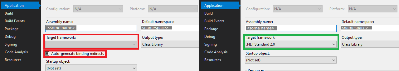

1.b) Also projects properties was displayed different:
Left - only SDK 2.1 is installed, Right - both 2.1 & 5.0 are installed
My question is - Why installing of SDK 5 affects the solution, all projects of which have a TargetFramework either netstandard2.0 or netcoreapp2.1?

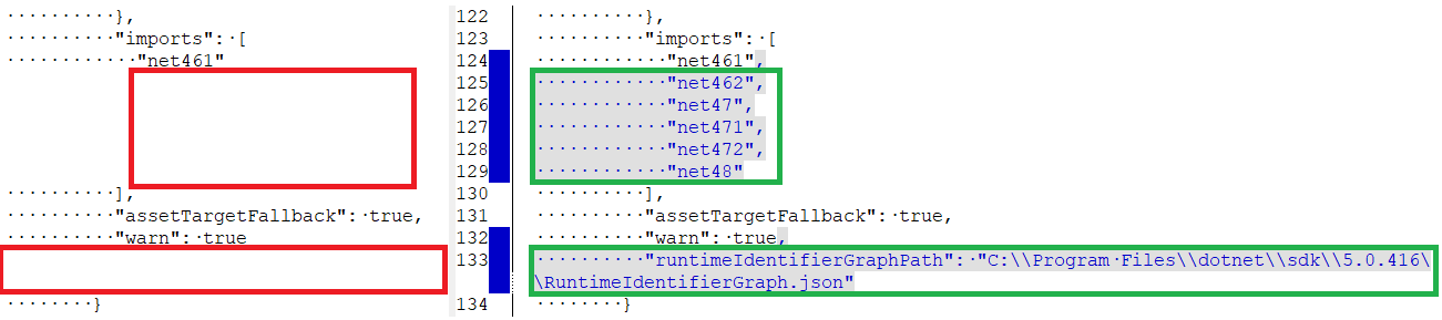

2.b) All jsons in projects obj folders (e.g. project.assets.json) had different:
  • addersses of nuget:
    -2.1 build: www.nuget.org/api/v2
    -5.0 build: api.nuget.org/v3/index.json
    • And different "project"->"frameworks"->"netcoreapp2.1"->"imports" and "runtimeIdentifierGraphPath" sections:
      Left - 2.1 build (only SDK 2.1 is installed), Right - 5.0 build (both 2.1 & 5.0 are installed)
