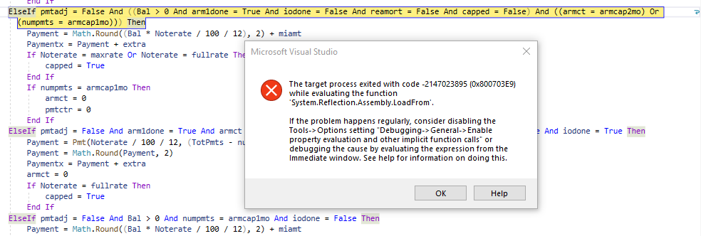

"The target process exited with code -2147023895....

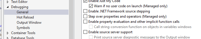

If the problem happens regularly, consider disabling the Tools->Options setting Debugging->General->Enable property evaluation and other implicit function calls
I unchecked this option in tools debugging and it did NOT fix the problem. This is real inconvenience. What can I do? I need to see the VALUES in my variables.. It WAS working ok. Why does it now no longer work and I'm sitting here typing this post? Is it infected with a virus? Is this just some general glitch that gets worse as web pages get larger? My code behind page has 17k lines of code but I doubt that has anything to do with this debugging issue.

  2. Scot King 116 Reputation points
    2023-05-26T13:50:03.3333333+00:00
    I have rebuilt my program and it doesn't help. I still get this error message when I attempt to hover my mouse over any variable in my program. This is really annoying...
    I have also removed the check from Enable property evaluation and other implicit function calls. This does not help either. Shall I just now uninstall VS 2019? It is worthless to me without a solution to this problem.

    1. Managed Compatibility Mode:
      • In some cases, enabling Managed Compatibility Mode can address debugging issues. To enable it:
        1. Go to Tools > Options.
          1. Navigate to Debugging > General.
            1. Check the box for Use Managed Compatibility Mode.
              1. Restart Visual Studio and try debugging again.
    Here is what Managed Compatibility Mode is and does:
    • When this mode is enabled, the debugger behaves more conservatively and avoids certain features that might cause issues with managed code debugging.
    • It helps address compatibility problems that can arise due to differences between the debugger's behavior and the behavior of older versions of the .NET runtime.
    • Specifically, it affects how the debugger evaluates expressions, inspects variables, and interacts with the runtime during debugging sessions.Found the answer using CoPilot...
