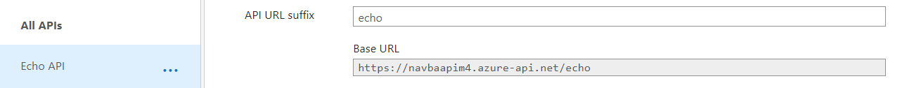

    2. Check if you have the correct API URL suffix added and you are calling the correct API while accessing the API from gateway url.
