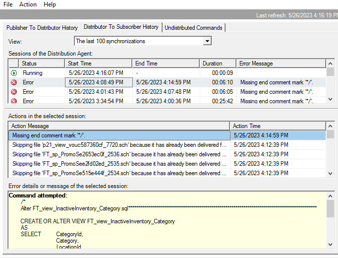

I'm setting up a transactional replication between an on-prem server and an Azure VM with SQL. The snapshot and publication are without error.

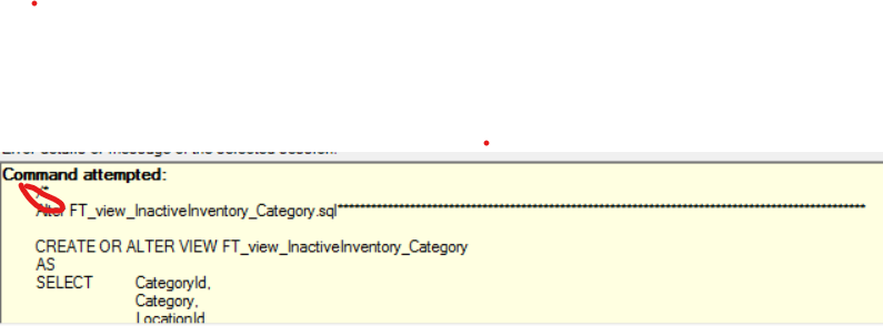

During the initial sync it is failing and the action message is "Missing end comment mark"*/". In the details I can see where this is true in the script snippet it shows, but I cannot find where this script is, or the name of it to fix it. It will not go past this. I do see a view that's referenced in the script and I excluded it from the publication, but that did not help.
I'm looking to see if there's a way to see what script this file is in so i can fix it and get past this error. Any help appreciated!

    It's hard to tell what's the issue without the full script.
    I guess you might missing '*/' at the end of the script.

    You need the check SQL script thoroughly to find the missing part or you can remove '/*' at the beginning of your script.
