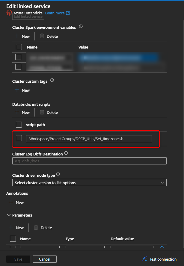

Is it possible to run an init script from ADF pipeline that is located in the Databricks Workspace?
2023-05-27_10h49_26
It seems that the default pathing to a configured init script is dbfs. I namely receive the error below:
2023-05-27_10h51_17
Thank you in advance!

    @Tom Leeflang - Thanks for the question and using MS Q&A platform.
    Init script path should be a folder in the dbfs - example: dbfs:/databricks/scripts/initscript.sh
    As per the repo, I had created a init script named odbc-install.shand upload to the folder named dbfs:/databricks/scriptsand path looks like this:
    dbfs:/databricks/scripts/odbc-install.sh
    Now pass the same path of the init scripts in the ADF linked service as shown below.
    When I ran the Databricks Notebook activity, I'm able to install the initscript succesfully without any issue.
    Here is the Event logs of the cluster:
    Hope this helps. Do let us know if you any further queries.
