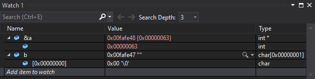

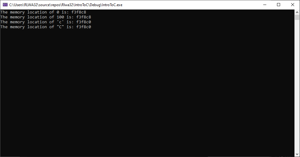

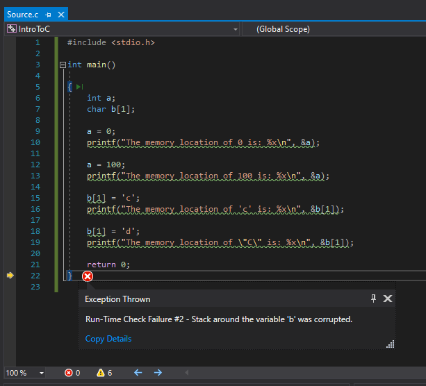

    Hopefully the following will clarify for the Questioner how the stack based variables (int a and char b[1]) appear in memory, why the same addresses are printed and the effect of the buffer overflow from the coding error contained in the code here:
    #include <stdio.h>
    int main()
        int a;
        char b[1];
        a = 0;
        printf("The memory location of 0 is: %x\n", &a);
        a = 100;
        printf("The memory location of 100 is: %x\n", &a);
        b[1] = 'c';
        printf("The memory location of 'c' is: %x\n", &b[1]);
        b[1] = 'd';
        printf("The memory location of \"C\" is: %x\n", &b[1]);
        return 0;

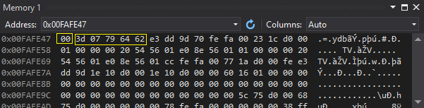

    Uninitialized variables before assigning 0 to a -
    watch_uninitialized
    memory_uninitialized
    The first byte highlighted is the 1 byte array b and the second 4 bytes highlighted are the int variable a. Note that the addresses in the watch window agree with the addresses in the memory window.

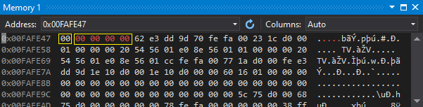

    Now, assign 0 to a -
    watch_A0
    memory_A0
    Note that the changes from the assignment are displayed in red.

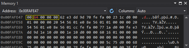

    Assign 100 to a -
    watch_A100
    memory_A100

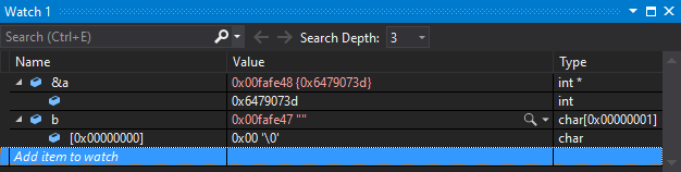

    Now for the incorrect code that writes to a memory address b[1] that is outside the bounds of the char array. Assign 'c' to b[1] -
    watch_b1c
    memory_b1c

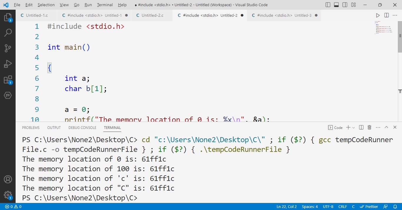

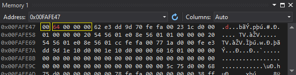

    Results of coding error should be evident. The 1 byte char array b is untouched. However, writing outside the bounds of the b array changed the value of the int a variable. Addresses &a and &b[1] point to the same location in memory. The same thing happens when the next statement assigns 'd' to b[1] -
    watch_b1d
    memory_b1d
    The above results and reproduction of the Questioner's "same address" issue was produced with an x86 debug build with runtime checks disabled.

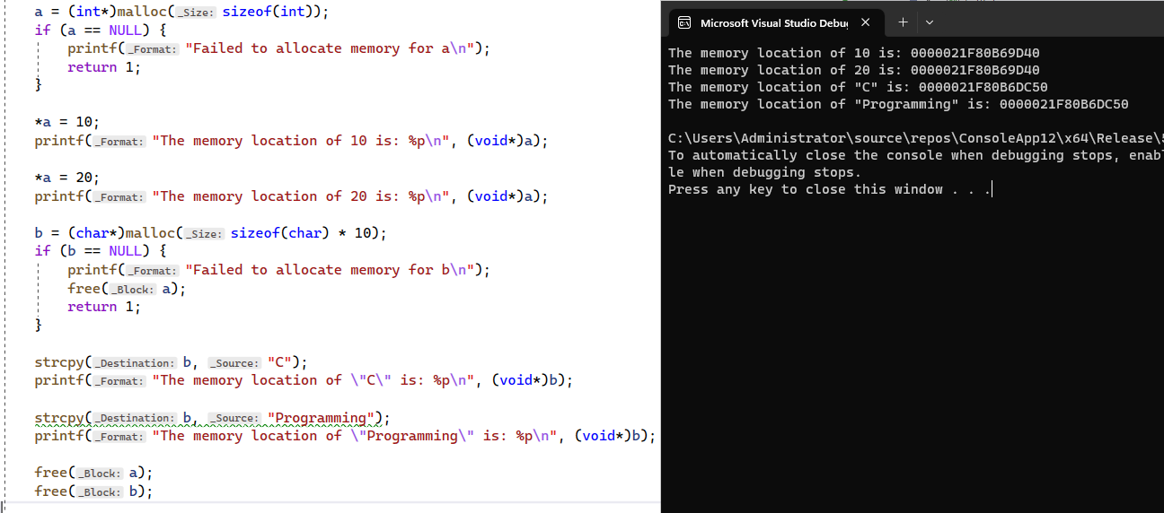

    2023-05-29T09:10:42.4566667+00:00
    Hi @Debojit Acharjee , Welcome to Microsoft Q&A.
    A pointer of class int has an address assigned when it is declared.
    You just modified the value on the address, and did not modify the address itself so it will not change.
    It was as if there was just another person in the house, and it was still the same house.
    For char pointers.
    And actually using different compilers, this may change.
    For correct use, you should manually assign memory space.
    #define _CRT_SECURE_NO_WARNINGS
    #include <stdio.h>
    #include <stdlib.h>
    #include<string>
    int main()
    	int* a;
    	char* b;
    	a = (int*)malloc(sizeof(int));
    	if (a == NULL) {
    		printf("Failed to allocate memory for a\n");
    		return 1;
    	*a = 10;
    	printf("The memory location of 10 is: %p\n", (void*)a);
    	*a = 20;
    	printf("The memory location of 20 is: %p\n", (void*)a);
    	b = (char*)malloc(sizeof(char) * 10);
    	if (b == NULL) {
    		printf("Failed to allocate memory for b\n");
    		free(a);
    		return 1;
    	strcpy(b, "C");
    	printf("The memory location of \"C\" is: %p\n", (void*)b);
    	strcpy(b, "Programming");
    	printf("The memory location of \"Programming\" is: %p\n", (void*)b);
    	free(a);
    	free(b);
    	return 0;
    Best Regards,
