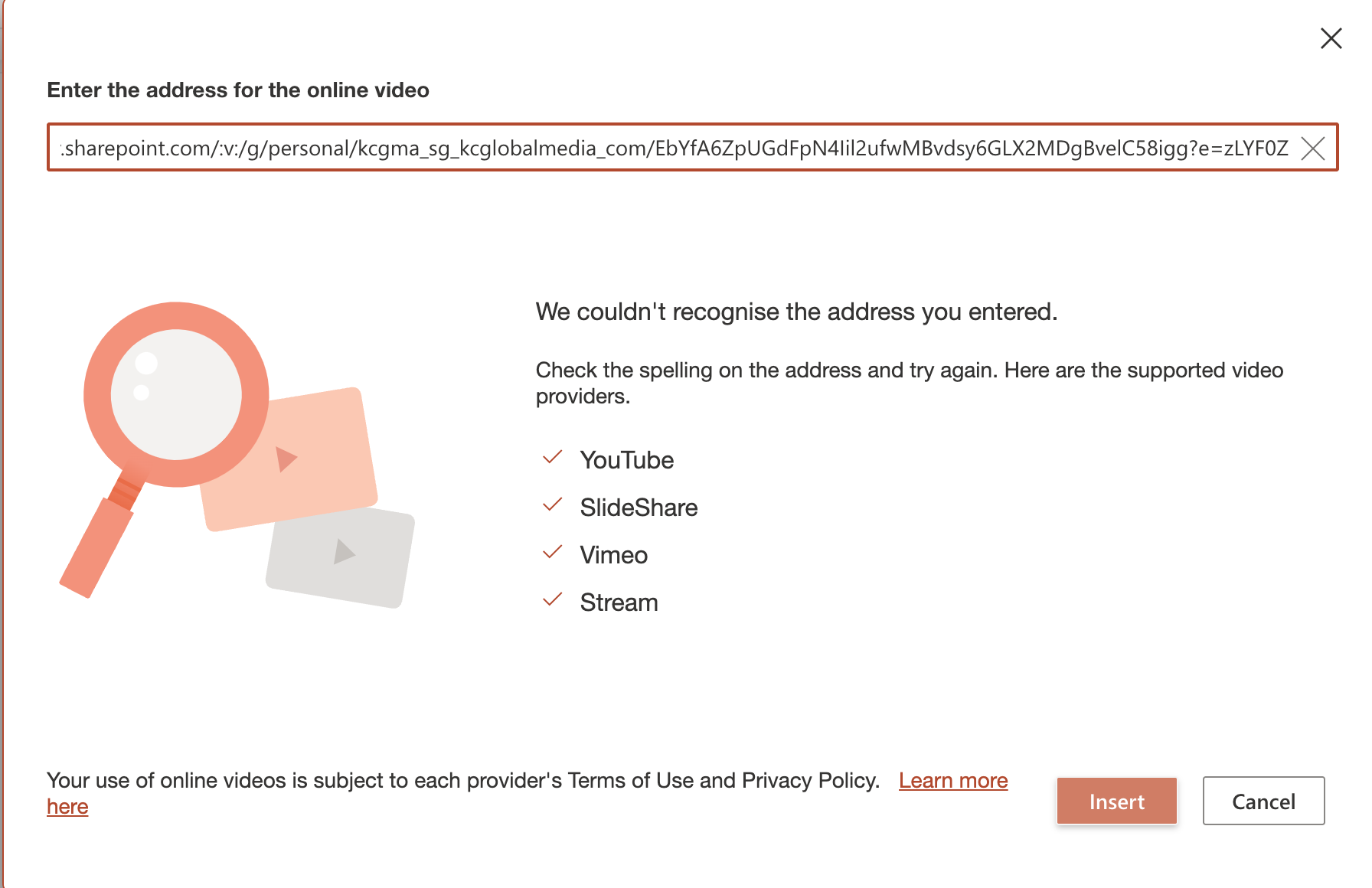

I'd like to insert a video from Stream Sharepoint into my slides, but says couldn't recognise the address.
Is there anyone know how to fix this? Thank you in advance!

    Based on my tests, at current time, Stream on SharePoint is not supported to be inserted into PowerPoint as online videos.
    Stream (Classic) videos are supported, but Microsoft Stream (Classic) will be retired February 15, 2024 and replaced by Stream (on SharePoint).
    For more, please refer to following threads:
    Insert Stream (SharePoint) Link in PowerPoint
    Regarding the PowerPoint “Enter online video address” functionality
    Thanks for your understanding.
