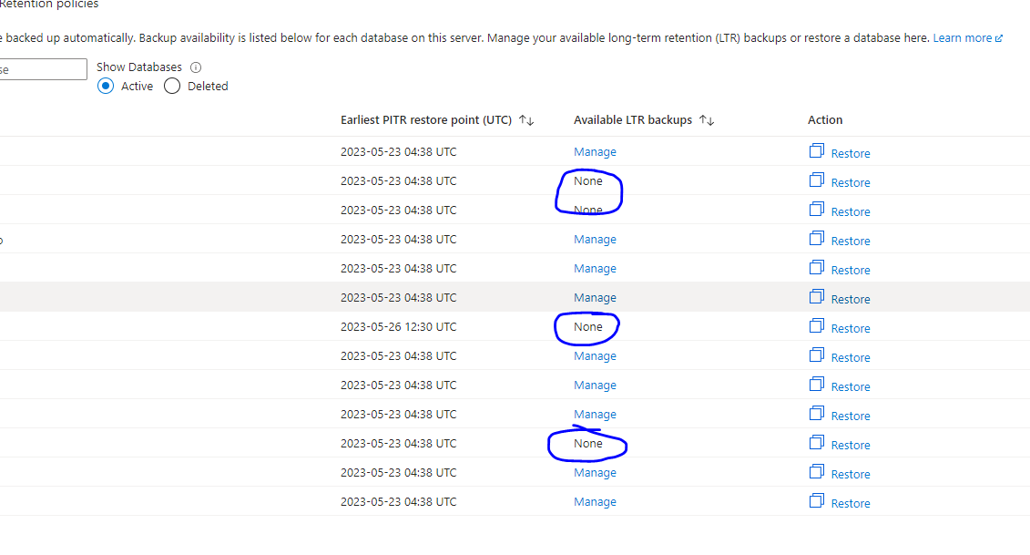

Hello,
Can we make an script / automation to detect if there any SQL Database with no available LTR backups?

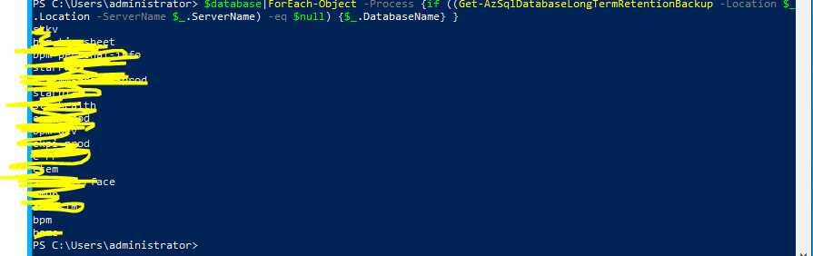

    Below will return list of databases on Azure SQL without LTR backup, excluding master:
    $databases = Get-AzSqlDatabase -ResourceGroupName yourResourceGroup -ServerName yourAzureSqlServer|where DatabaseName -ne "master"
    $databases|ForEach-Object -Process {if ((Get-AzSqlDatabaseLongTermRetentionBackup -Location $_.Location -ServerName $_.ServerName) -eq $null) {$_.DatabaseName} }|Out-File databases.txt -noClobber
    -TP

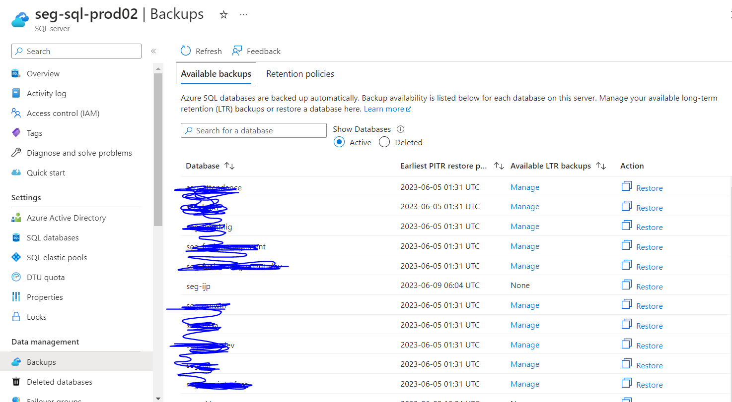

  1. TP 146.3K Reputation points Volunteer Moderator
    2023-06-12T06:12:18.83+00:00
    So that I can try to recreate this, can you tell me what might be different about this database, besides the name? I see the earliest PITR is more recent than the others in the list, and you mentioned LTR isn't enabled for it, anything else?
