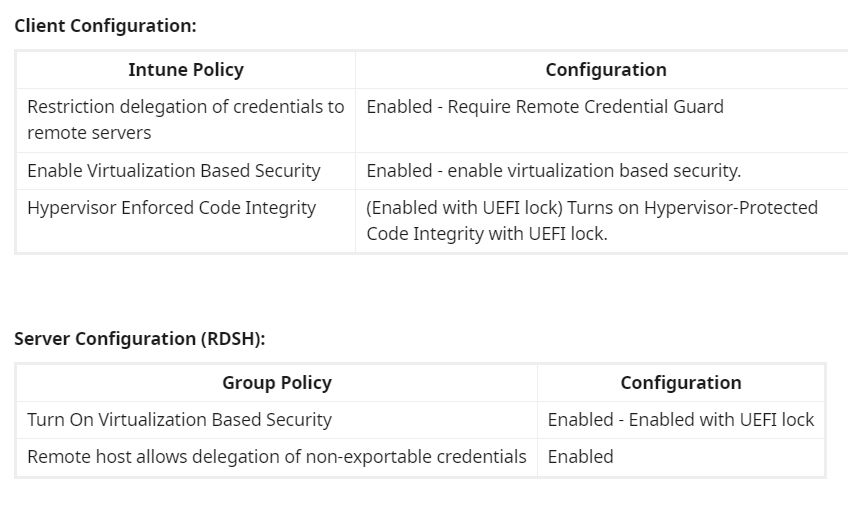

To confirm, VBS is enabled on the environment I'm trying to access (Windows Server 2022) with required credential delegation. It works by IP, but DNS seems to be non-existent when authenticating with RCG.
I can resolve DNS of the resources in CMD and it shows with ticket in klist with hostname against it, but when trying to navigate/reach it fails with being unable to find (DNS error).
Can you share your environment/policies? This is what I have set.
