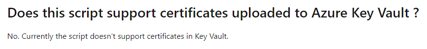

    As of today, it is not supported:
    enter image description here
    Refer: https://learn.microsoft.com/en-us/azure/application-gateway/retirement-faq#does-this-script-support-certificates-uploaded-to-azure-key-vault-
    However, I checked with the Azure Application gateway Product Group team, and they mentioned that this is planned as part of script enhancement. I've not received any specific ETA, but it will be available soon.
