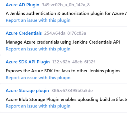

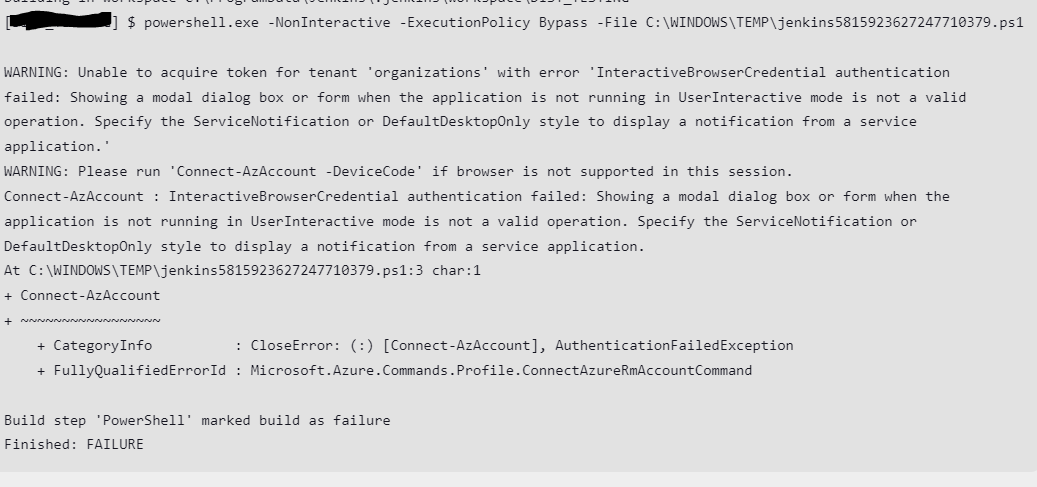

I tried to connect the Microsoft Azure storage blob through Jenkins by using connect-Azconnect after installing the necessary plugins in Jenkins. Can you please confirm if any other configuration is required in the system or where its stopping to connect the azure storage?

    4. Jenkins Job Configuration: In your Jenkins job, add a build step to execute the Azure CLI commands. For example, you can use a "Execute shell" or "Execute Windows batch command" build step, and then run the Connect-AzAccount cmdlet to establish the Azure connection. Make sure you're running the Jenkins job on the system where Azure CLI is installed and configured.
    5. Verify Connection: Run your Jenkins job and check the console output for any errors or issues. Make sure the job successfully connects to Azure using Connect-AzAccount.
