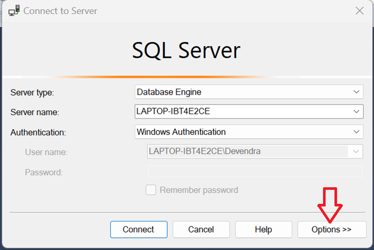

  1. Devendra Kumar Sahu 246 Reputation points
    2023-06-02T07:39:57.1333333+00:00
    1. Go to Options button.

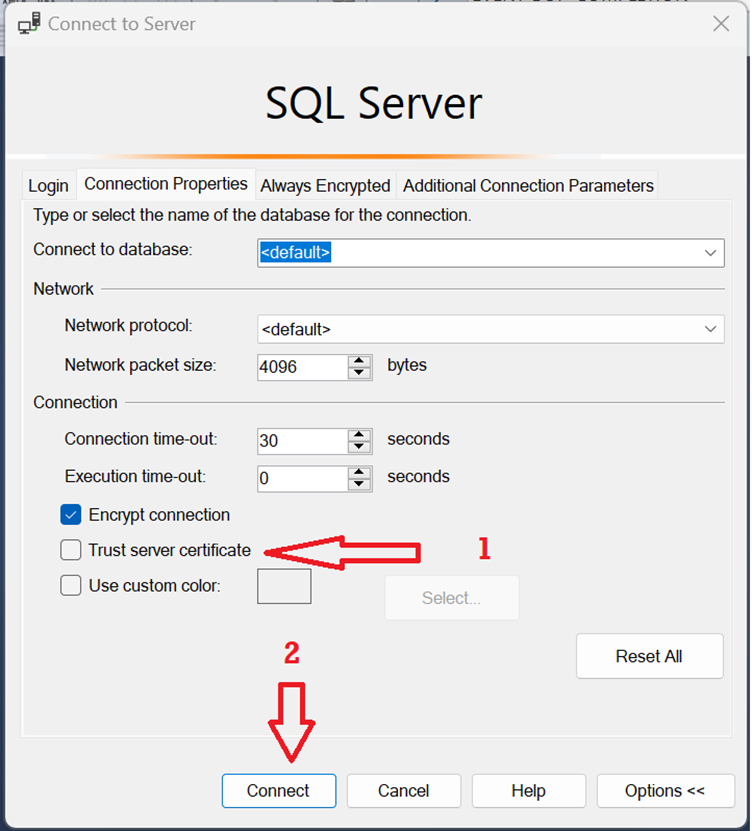

    2. Tick mark for “Trust server certificate” than
    3. click Connect button.
