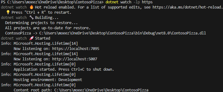

  1. Moeez Abdul 170 Reputation points
    2024-04-02T10:15:52.03+00:00
    In my case, I just ran this command in my CLI from the Root Directory, and it just Fired up:
    dotnet watch -lp https
    CLI Image
    34 people found this answer helpful.

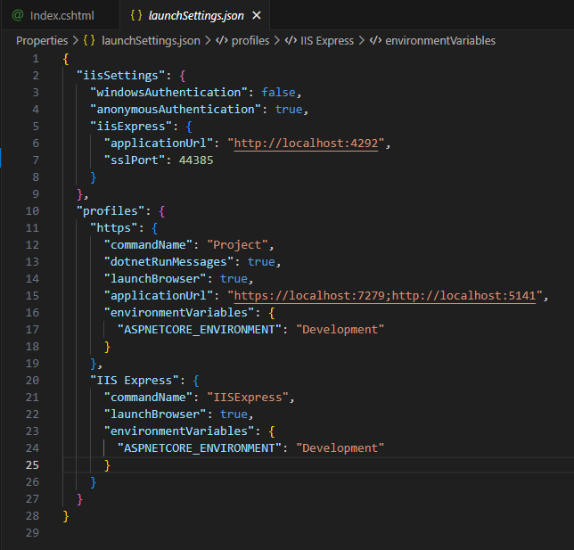

  2. Erick A. Capitanachi González 95 Reputation points
    2023-10-22T15:46:50.16+00:00
    In my case it works when I delete the "http" of the "profiles" section in launchSettings.json like this:
    19 people found this answer helpful.
