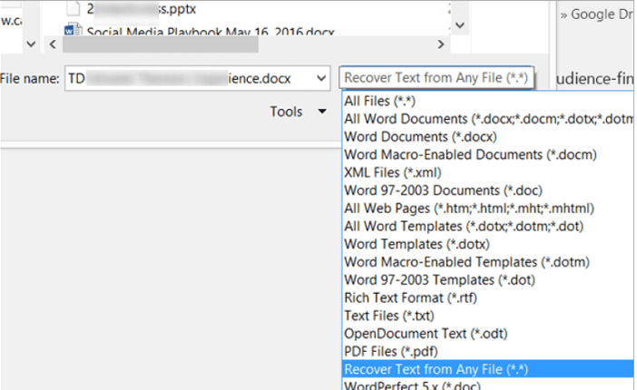

    May I know the scope of this issue, only this one specific file or all the files you can't open? Usually, the Word found unreadable content error indicates file corruption, which may be caused by various reasons like virus attacks, file conversion, sudden power outages, etc.
    Firstly try to open and repair a corrupted Word File on Mac:
    Step 1. Launch the Word on Mac. In the main menu, click on "File" > "Open".
    Step 2. Find the drop-down menu titled Enable( Show). Select the option "Recover Text from Any File".
    Step 3. Navigate to your corrupted Word file. Follow on-screen instructions to complete the recovery process.
