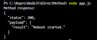

    Here is a code that I have tested and could successfully invoke the direct method on a device from Node.js code
    'use strict';
    const connectionString = '<Connection string>';
    const serviceClient = iothub.Client.fromConnectionString(connectionString);
    const methodName = 'reboot';
    const payload = {    input1: 'someInput',    input2: 'anotherInput'};
    serviceClient.invokeDeviceMethod('TestDevice4', { methodName, payload }, (err, result) => {
       if (err) {
           console.error('Failed to invoke method: ' + err.message);
       } else {
           console.log('Method response:');
           console.log(JSON.stringify(result, null, 2));
    I have used the Service policy connection string of IoT Hub in this code and here is the output I get from the code as I execute it.
    enter image description here
    Hope this helps. Please let us know if you have any additional questions or need further assistance.
