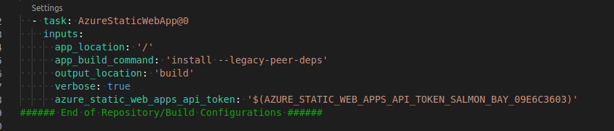

I cant deploy a application in my Azure Static Web App using azurepipeline from Azure DevOps
I read about custom command in https://learn.microsoft.com/en-us/azure/devops/artifacts/npm/npmrc?view=azure-devops&tabs=windows%2Cclassic but this isnt work for me
this is the pipeline
when I run the pipeline Oryx tell me about the custom command OK
but Oryx doesnt run install --legacy-peer-deps

  1. brtrach-MSFT 17,741 Reputation points Microsoft Employee Moderator
    2023-06-07T03:32:13.68+00:00
    One thing you can try is to modify the app_build_command to npm install instead of install --legacy-peer-deps. This should work as Oryx automatically adds the --legacy-peer-deps flag when running npm install.
    If this does not work, you can try adding a custom command to your pipeline to run npm install --legacy-peer-deps before building your application. Here is an example of how you can modify your pipeline to include this command:
    - script: |
        npm run build
      displayName: 'npm install and build'
    This will run npm install --legacy-peer-deps to install the dependencies with legacy peer dependencies and then run npm run build to build your application.
    Please reply back to this answer if you have any questions or if the above suggestions did not work.

  1. Gautam Kumar 5 Reputation points
    2023-07-13T03:30:51.3733333+00:00
    It's works for me
    trigger:
      - develop
    pool:
      vmImage: ubuntu-latest
    steps:
      - checkout: self
        submodules: true
      - task: AzureStaticWebApp@0
        inputs:
          app_build_command: node --max_old_space_size=8192 ./node_modules/@angular/cli/bin/ng build -c develop --build-optimizer
          app_location: '/'
          api_location: 'api'
          output_location: 'dist/crm'
        env:
          azure_static_web_apps_api_token: $(deployment_token)
          NPM_CONFIG_FORCE: true
          NPM_CONFIG_LEGACY_PEER_DEPS: true
    2023-06-07T09:32:30.8133333+00:00
    Ok thanks it works!
    2023-06-07T09:32:31.23+00:00
    Ok thanks it works!
