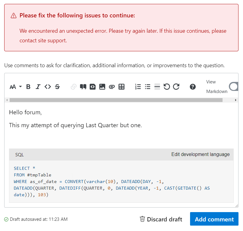

    P.S.
    If someone could help with the Last Quarter End but one that would be most appreciated.
